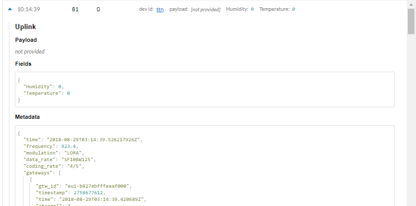

Your node is using port 0 for the uplink. That is not allowed for uplinks.

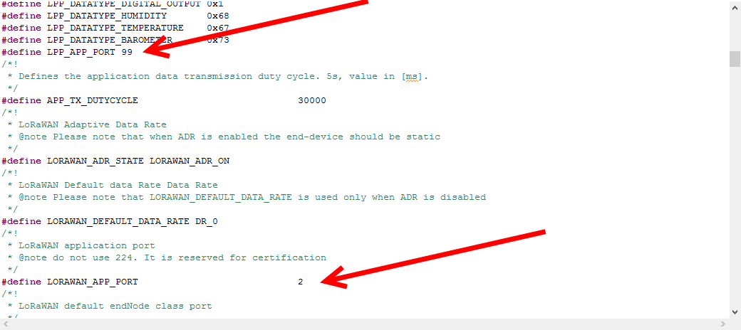

I using STM32 Discovery kit. I setup LORAWAN_APP_PORT 2 and Cayenne PORT 99.
The images in your first post show port 0, next to counter 81, so probably something is wrong in your node.
I understanding first uplink port 0 for check ADR right.
I don’t understand what you’re trying to say, but ADR is not related to the LoRaWAN port 0. If a node wants to enable ADR, then it sets a bit in a regular uplink message. That uplink should not be sent to port 0.
According to the spec port 0 is for mac commands (up and down link) with no payload.

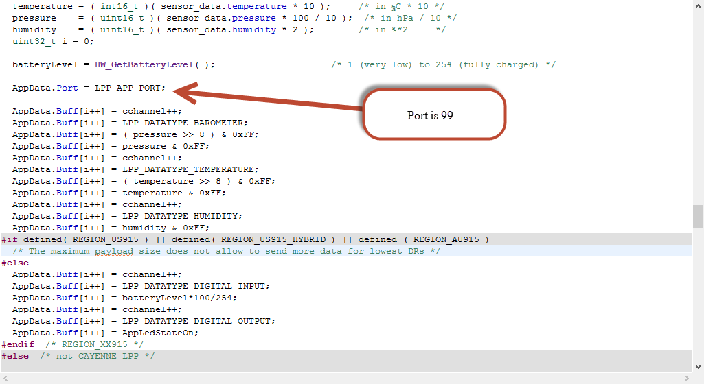

Can you post the function that prepares your uplinkdata?
You need to find the location where the Tx data is prepared, the function is most likely in your main.c assuming the stack hasn’t changed much.

LPP_APP_PORT is unrelated to LORAWAN_APP_PORT that you showed in an earlier post. (The first is just one of the many details that, in my opinion, cause unneeded overhead in the Cayenne LPP protocol. But that’s unrelated to your problems.)
Ok , you also need to set your AppData.BuffSize, where did you set this? should be the length of your buffer.
