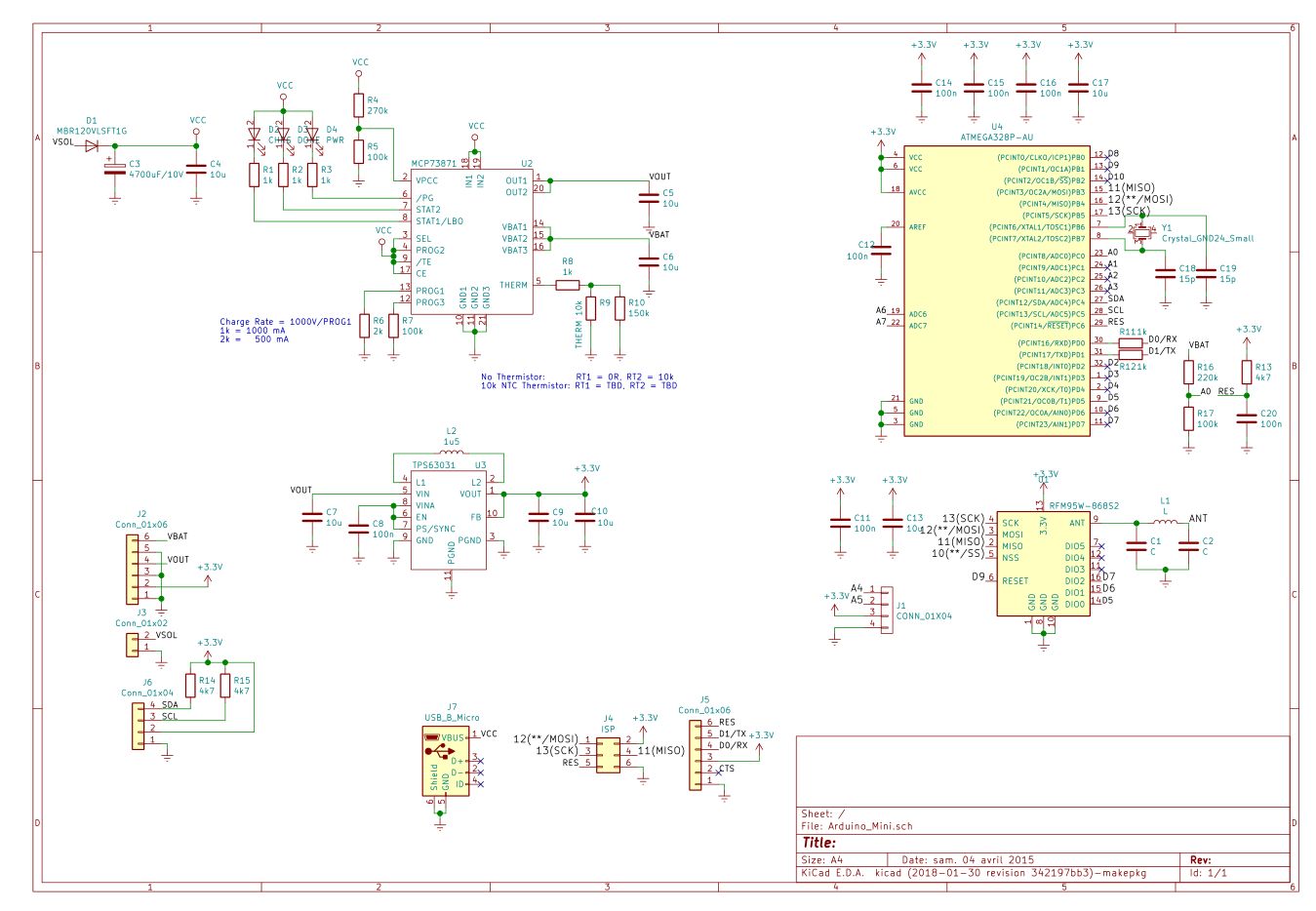

I finished my LoRa node.
It uses the MCP73871 - USB/Solar panel charger and very nice TPS63031 Buck-Boost Converter. Main benefits of the board is small size and possibility to run literally forever from one small single cell LiPo battery.
Source files here:
I will be happy If you have any suggestions.
