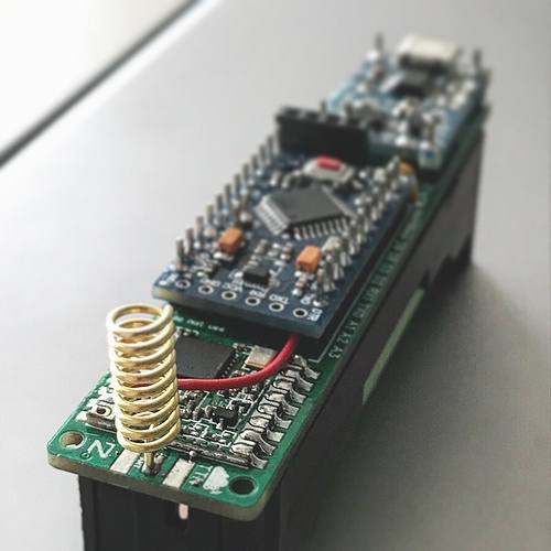

So. My first own blog is ready. Iāve been wanting to do one for a long time and now that Iām spending a lot of time with TTN, I thought it was the best time!
Here is the link to the article about this node. A little more detailed and also with shopping list:
For those who are really interested in my design, I have 10 PCBās as gift (only shipping costs) in return for your experiences in this forum. The second PCB design planned is a sensor/supercapacitor board (as piggy-back for the Arduino/RFM95). Capacitor charged (in my case) with a 1.5W/5V solar panel.

I have just measured the power consumption and also optimized the code:
https://mariozwiers.de/2018/04/04/arduino-lmic-library-with-low-power-mode/

It looked so good, but it was too good to be true. he has installed the RFM96W and not the RFM95W. on the one hand that means 13 instead of 20 dbi output, but more importantly no lora modulation!
But the solution with the MCP16251 step-up switching regulator is great and I will take on my node. such a board for lora, just for this price would of course top!

I received it today. Looks very nice, in particular that you added the ground plane below the rfm. Iāll order some components and then Iāll post an update.
received today a well documented gift.  Thanks @Wijnand
now itās soldering time
soldered, up and running
and already some ideas
