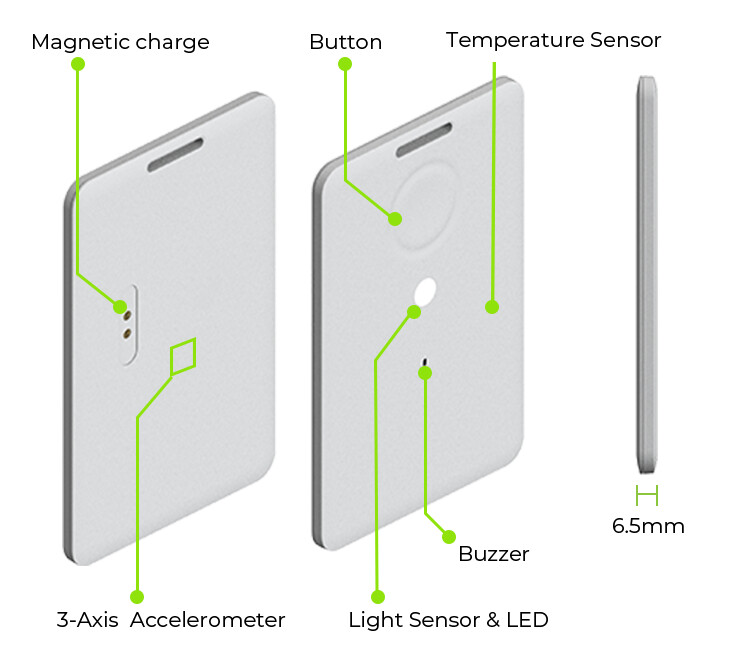

Hi :wave: , Recently I got a chance to be hands-on with the latest SenseCAP T1000, It is a compact LoRaWAN tracker that utilizes GNSS/Wi-Fi/Bluetooth for precise indoor & outdoor location tracking. I think this will be suitable for your application. You can find more details here at https://www.seeedstudio.com/sensecap-t1000-tracker product page.

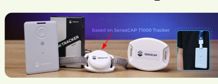

don’t think the formfactor lends it to pet tracking
Poor battery life and weird form for animal. But it seems a nice product for other applications.
@Piet_Pillay @clv , It’s a family of devices, so you can customize or use the best option for you, You can see they have a pet tracker-specific one for the situation.
Regarding the battery, I think it has decent battery life, and when you disable the sensor and reduce the sync time you can achieve better backup.
Thank you, they seem nice. But I found only these trackers from them.
@clv They are on Kickstarter and will be live on coming days. You can apply for the pre-launch here https://www.kickstarter.com/projects/seeed/sensecap-t1000-track-what-you-care-with-no-boundaries .
