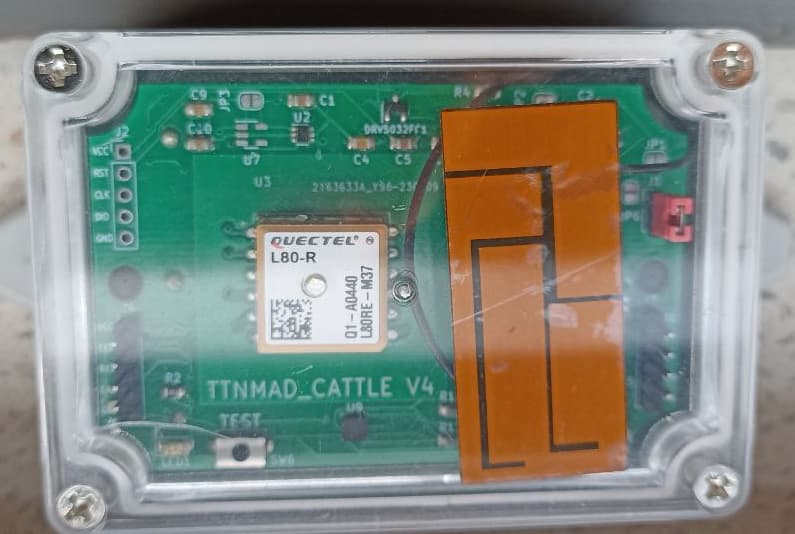

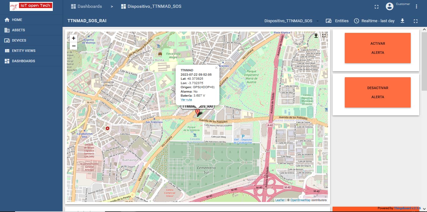

At TTN Madrid, we are working on 2 geolocation nodes:
  • TTNMAD_SOS: For on-demand people tracking (activated through a push button or remotely using a downlink command) using GPS ard/or WiFi AP geolocation based on Wigle. This device is powered with a rechargable 18650 Li-ion battery.
  • TTNMAD_CATTLE: For farm animals tracking (cows) using only GPS with 2 operation modes: regular that reports the last 4 positions every 15 minutes, and intensive that reports the last 4 positions every 5 minutes. This node is powered with LiSoCl2 batteries.
Both are programmed using STM32CubeIDE, and integrated in our platform “my IoT open Tech”, baed on ThingsBoard open source Community Edition.
The weight of these nodes is about 150 g, so probably not very cat-friendly.
imagen
All our efforts are open-source, but this is still a work on progress, so not ready for production deployment yet. Anyway, if you don’t want to start from scratch we are pleased to cooperate with other communities.

I see you use ThingsBoard. I will look into that. Thanks for the hint.

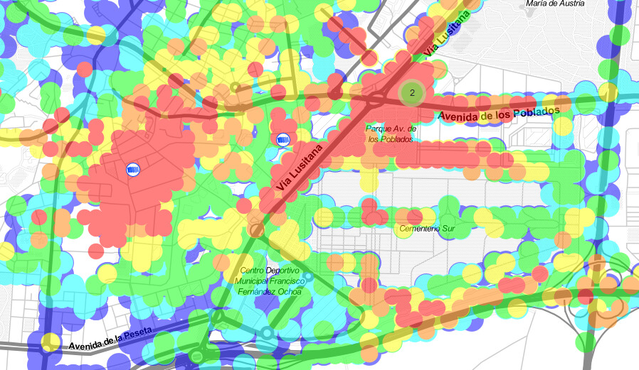

Regarding TTN coverage, we don’t develop these projects relying on present TTN coverage but just the opposite: we develop them to convince other citizens to deploy TTN gateways at their homes/offices.
Nevertheless, we have just got some uniform coverage in our neighborhood using a few gateways.

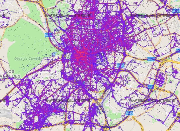

Regarding Wigle geolocation service, we use the Wigle phone app to contribute to the database frequently.
