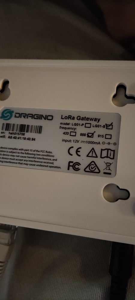

I am trying to send my first TTN message.
I have a dragino01 gateway on my desk, created and connected:
Gateway EUI : A84041194084FFFF
Status : Connected
I Created an APP:
I add 2 nodes.
I have a Heltec WiFi loRa 32 v2
One as ABP and another as OTAA.
My Heltec app show me this on Serial Port:
ESP32 MCU init…
ESP32 MCU inited OK!
Booting Sketch…
WiFi connected.
View page IP address:
192.168.1.65
Write page IP address:
192.168.1.65/w
DevEui=2232330000888802
LoRaWAN EU868 Class C start!
confirmed uplink sending …
teste_teste_teste
“teste_teste_teste” is my test string.
But I dont see nothing arriving on gateway or in APP live data.
My gateway only reports acknowledge message like these:
network_check 20:17:20 Receive gateway status Metrics ackr0rxfw0rxin0rxok0txin0txok0 Versions ttn-lw-gateway-server"3.15.1-SNAPSHOT-d4b4c6d2b"
network_check 20:12:20 Receive gateway status Metrics ackr0rxfw0rxin0rxok0txin0txok0 Versions ttn-lw-gateway-server"3.15.1-SNAPSHOT-d4b4c6d2b"
network_check 20:07:20 Receive gateway status Metricsackr0rxfw0rxin0rxok0txin0txok0 Versions ttn-lw-gateway-server"3.15.1-SNAPSHOT-d4b4c6d2b"
What is wrong? Please help me

Sorry bad news for you…
psper:
What is wrong?
The hardware you are using is not a LoRaWAN compliant gateway and you are now seeing the results. Please disconnect it as you will be causing issues for other TTN users. If you want to do LoRaWAN you need to use a compliant gateway.
BTW, please don’t use acknowledged uplinks. You are only allowed 10 of them a day in TTN.

Hi Kersing,
This gateway is not supported?
It is connected.
Thanks
kersing
(Jac Kersing)
October 24, 2021, 12:48am
4
Not for LoRaWAN. It is a Lora gateway, not a LoRaWAN gateway. Get a LPS8 or TTIG or something like it for LoRaWAN.
