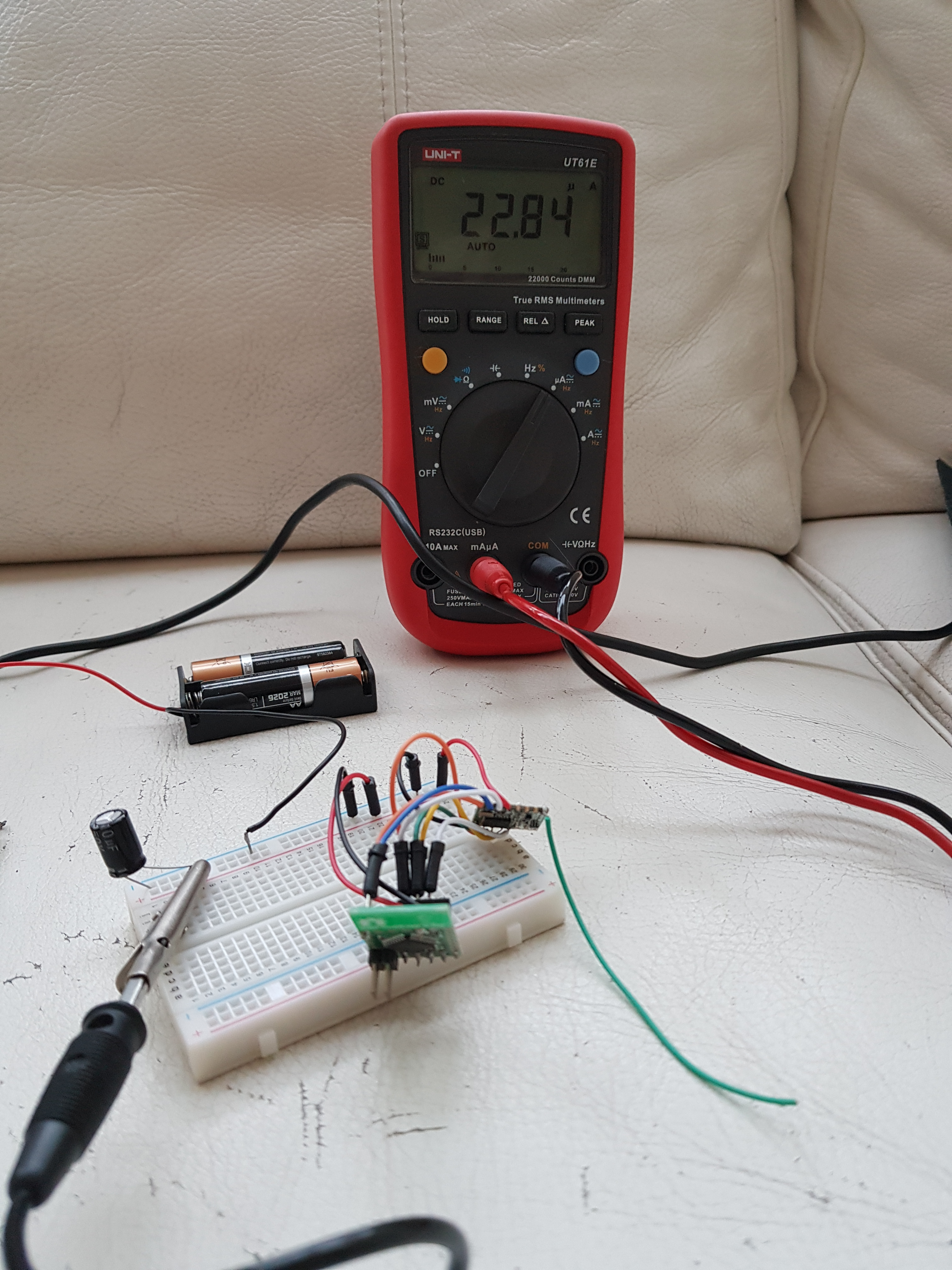

I have here a Sensebender on 23uA.
20180618_213452
Thanks that helped setting some expectations. I reconfigured everything from scratch and after lots of testing I get the same measurements as you so I think I am good.
I must have misconfigured the temp sensor and I was wasting excessive battery
