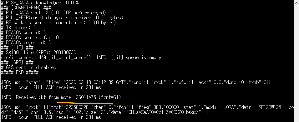

Here is my current configuration.
[gateway data]
[device data]
[lora_pkt_fwd data]

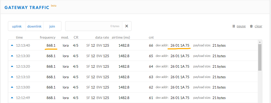

It seems that the data received by the gateway in ttn is not delivered to the device.
Why? Is the data from the gateway not being delivered to the device?

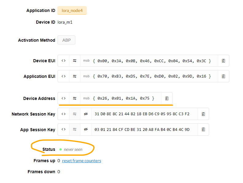

may I guess that you reseted your frame counter?
Your Cnt in the Data-console is 66
Your Cnt in the Overview-console is 0
I do not see any downlink messages in your console. I only see uplink messages from the node to the gateway.
So why do you think that you are sending data to the node?
Next questions: Are You using OTAA or ABP?
Could this be your problem?
I use ABP
If you look at the [gateway data] data above, you can see the data I sent in real time in the gateway traffic.
In the device overview, however, the frame up count is not available.
Maybe that’s the reason. Thank you
