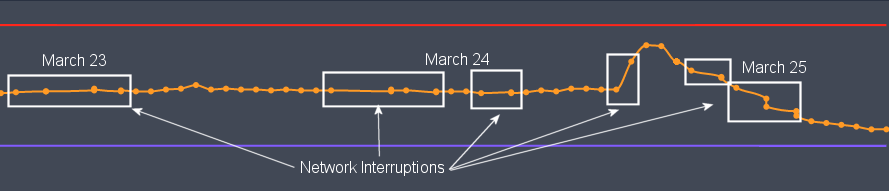

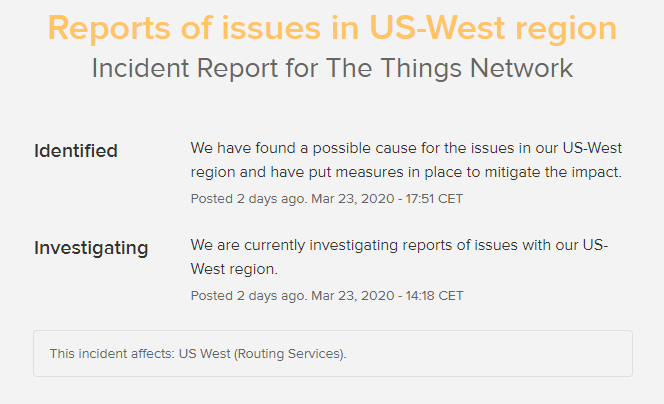

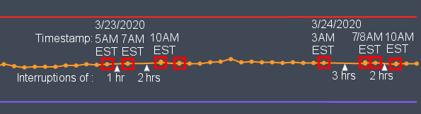

TTN-router-US-WEST is having issues as of ~5AM EST, where GWs may have been disconnected/not communicating for an hour, then briefly came back in ~7AM EST, then interrupted again and, as of 10AM EST back online FYI. I will continue to monitor thru out the day, if anyone else can validate this please chime in for the rest of the US / elsewhere community - thank you and all be healthy and good!
TTI is looking into the issue.
https://status.thethings.network/
@MicrochipTTN Thank you for the update! didn’t even know TTN had a ‘Status Page’ - much needed. Here’s our 48 hr timestamp of events as reported by one of our sensors FYI:
Thanks!

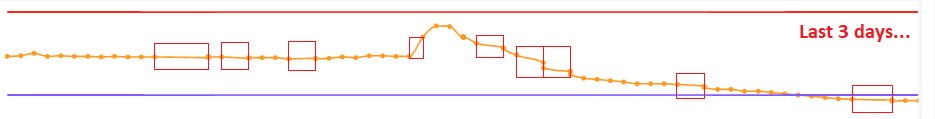

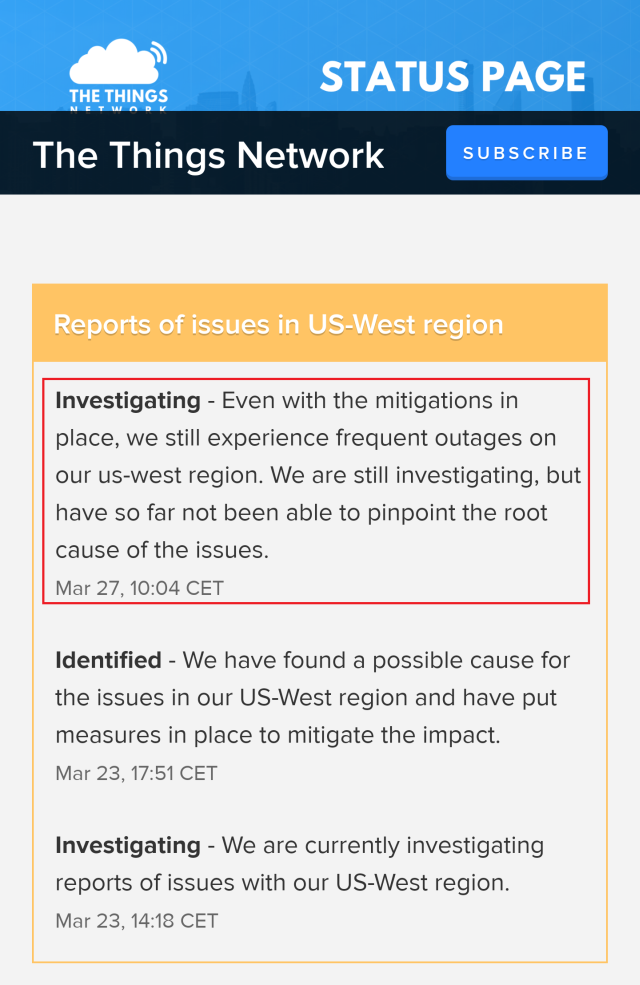

@MicrochipTTN Any new updates? The problems are still present (spread dots means connection issues >1hr)
No updates since 2 days ago:
Thanks!

@tbalon Correct; we’re still seeing ‘network disconnect gaps’ as well within 1,2 and even 3 continuous hours. Doesn’t mean the TTN server was down for 1,2 or 3 hours, but that it was not processing packets correctly / dropping packets within those hours:

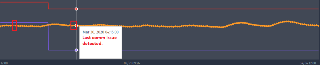

Everything seems to be back to normal since March 30 :
