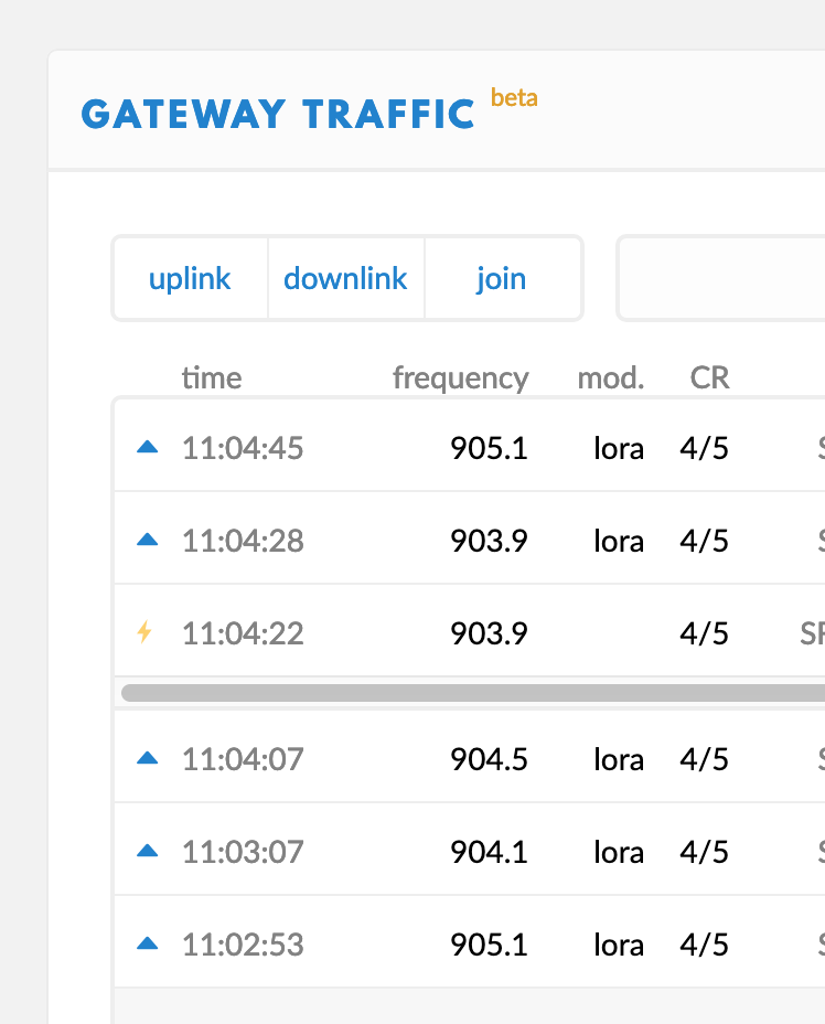

I am in the same boat here. 6 devices, geographically dispersed connecting to 5 different gateways. All went dark approx 15h ago. I can see encrypted traffic from the devices hit the gateway, but no application data for a system that has been running for ~2 years. One device+gateway is sitting here in front of me, if I power cycle it I can see the join messages in the application console, then it joins and starts transmitting data but no data is reaching the application @ TTN.
ok and what’s the reason of this problem ? Like you, I have 3 gateways running 22 devices with no problem over 1 year ago but problem since 15 hours ago
Logs on everything I can touch from my side look like they are working. LoRaWAN-attached MCU says it’s sending packets, gateway says it’s receiving packets, and gateway says it’s sending packets to TTN. TTN console reports my gateway is sending those packets, but my configured applications are not receiving them. Appears to be something on TTN side.

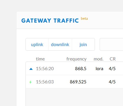

because traffic flows normally (EU)
workssunday
if I see where you all coming from, it looks like the ‘old’ US problem, or are there EU users experiencing the same at this moment ?

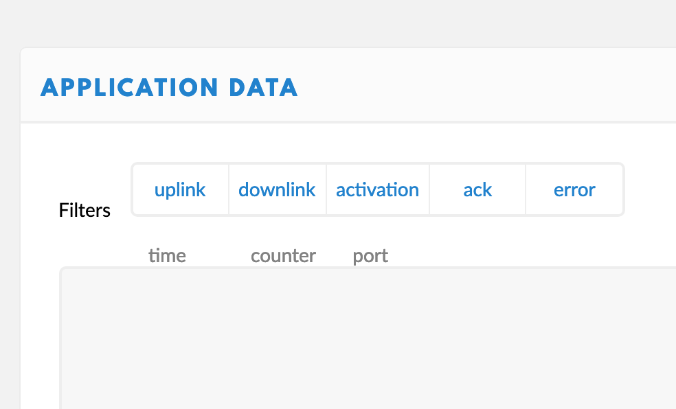

I get nothing in application and is not about integration. All work great since overs 1 year, no problems but now look from 16-17 hours I have nothing to the application

I can see join requests but no data from nodes at the application level.
I also have to query the last 19 hours from storage in order to see data.
