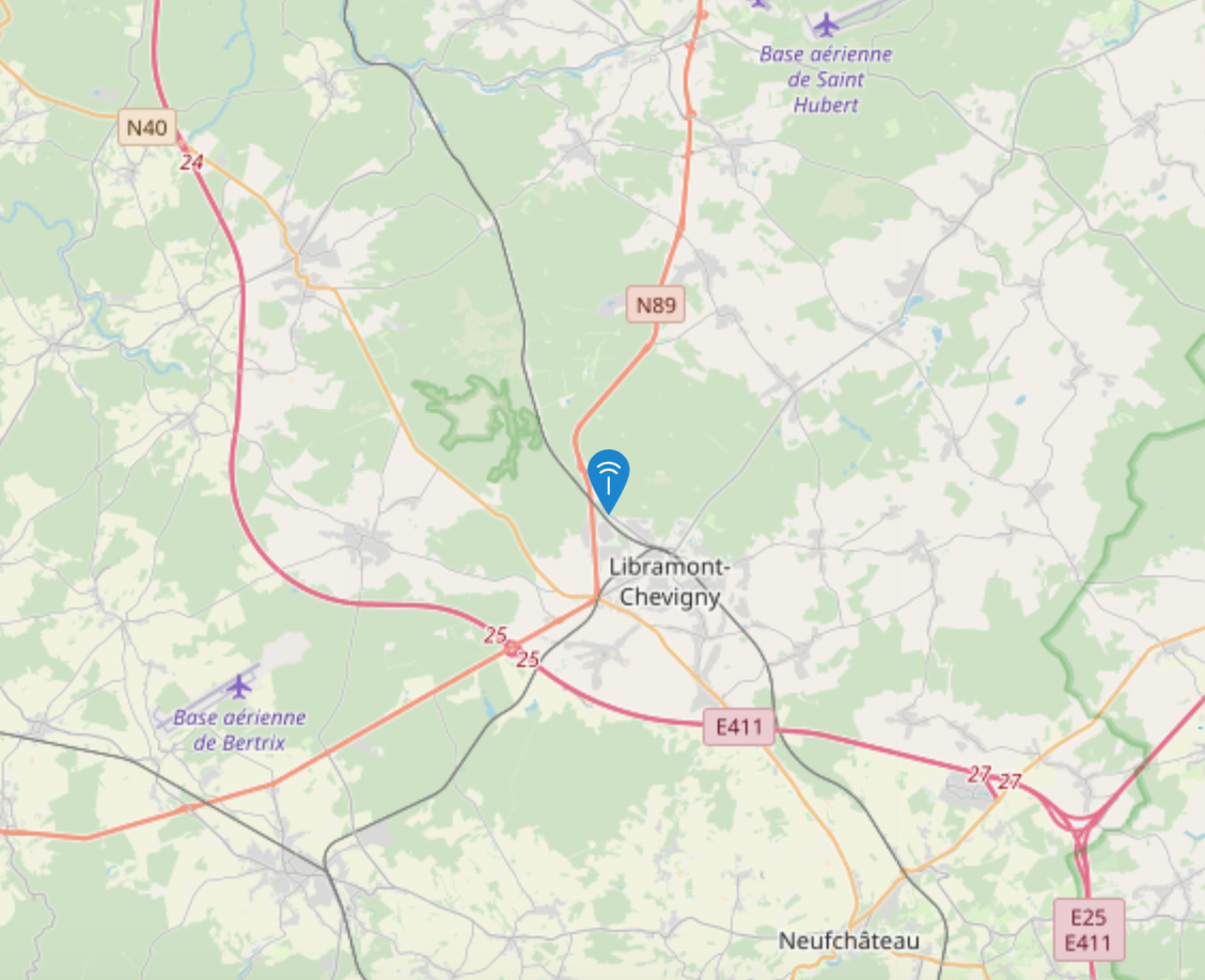

After that, I decided to switch for ABP connection and it’s was successful. I have all the time “Successful transmission” when I want to send something. But in these two options, I never receive something on my gateway (in TTN console). I have to check my several keys and so one. But my gateway has 0 packets receive again. The traffic page is blank on my gateway and on my application page. There is only my gateway in this place (sweet home campaign).

Mar 19 10:54:54 ttn-gateway ttn-gateway[333]: # Manual GPS coordinates: latitude 49.92908, longitude 5.35661, altitude 502 m
