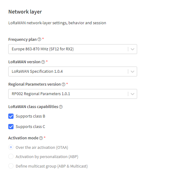

Again i dont think the problem is related to class c but because the device address isnt updated until after an uplink has happend. This can be seen if you join the network with OTAA and then check the end devices address under the network layer in general settings.
also i believe it does support class b and c

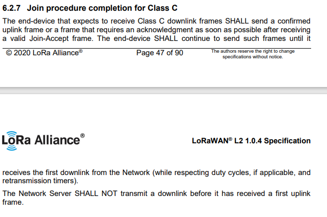

i just checked LoRaWAN-1.0.4-Specification-Package and it says that the network server should’nt send a downlink before it receives an uplink in class c (this is in section 6.2.7) so that expalins why i have to do an uplink before. but the weird thing is that the network server does in fact send a downlink its just the wrong address

my end node is using version 1.0.4 actually this specific join procedure didnt exist in 1.0.3.
Capture
