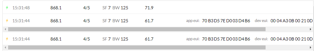

So i have a dragino lora hat on my raspberry pi 4 and a node which makes use of the RN2483A microchip and i have them both registered in ttn where i watch the trafic. Now i send OTAA join requests manually with the passtrough arduino sketch via the serial monitor and everytime i send one on the correct spreading factor and datarate (SF7, DR 5) i get this: image and the node says denied and i think thats because the join accept is not correctly being sent by my gateway since my node can join via other gateways setup around my area and the same happens with other peoples nodes configured the same way when they try to join via my gateway but then when they try it with another gateway via another spreading factor and datarate it works, so it has to be my gateway thats not sending the join accept right but i dont know why or how to fix it and ive been struggling with this for weeks.
Single Channel Packet Forwarders can only listen on one channel, devices expect 8.
We can only support full 8 channel gateways on TTN as anything else is hugely disruptive to the network - a forum search will reveal more detail.
Basically you’ll need to get a gateway to move forward.
