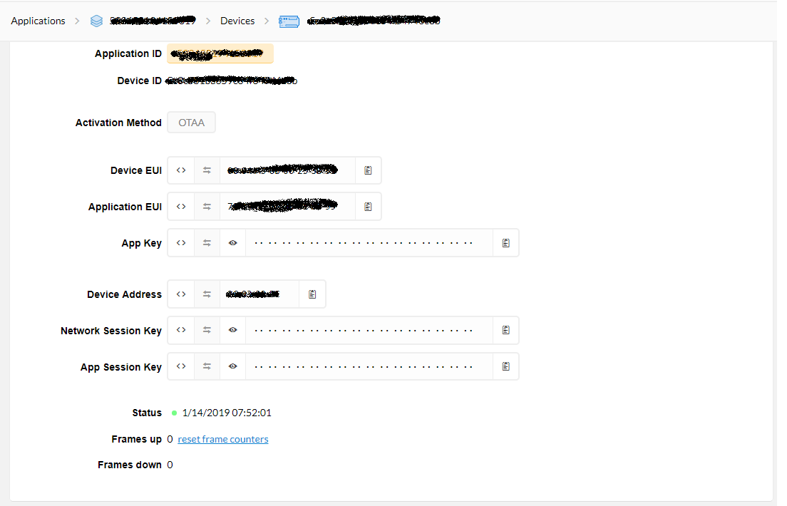

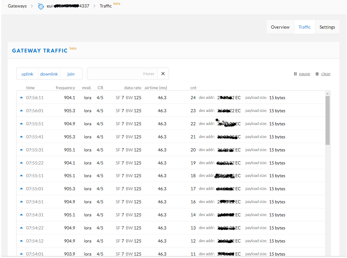

Yes, it is working but can not downlink and also to see the status of the device just by clicking F5 on the console page. I have not been able to work with my system for 6 days because of this problems with TTN.
In the figures (first device figure and second gateway) the last update of the device was at 07:52:01 today (since I reinitiated the controller) but at the gateway it presents 07:56:11 (print screen time). The device showed in the status 4 minutes of the last update but if I click F5 it shows the update in a few seconds and increments the value. But as seen in the figure of the gateway the data arrives every 10 seconds for UpLink.
And I can not do donwlink at all.
This is all for the handler: "ttn-router-us-west" for others except "ttn-router-brazil" only does the join and then on the device console I can not see the status even by clicking F5 .

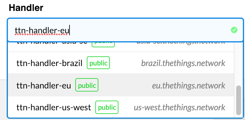

…I assume you meant: In the “Application” the “Handler” is “ttn-handler-us-west”? (I never understood why one can type anything one likes into the settings, rather than being limited to selecting one from the dropdown; probably to specify private handlers?)
