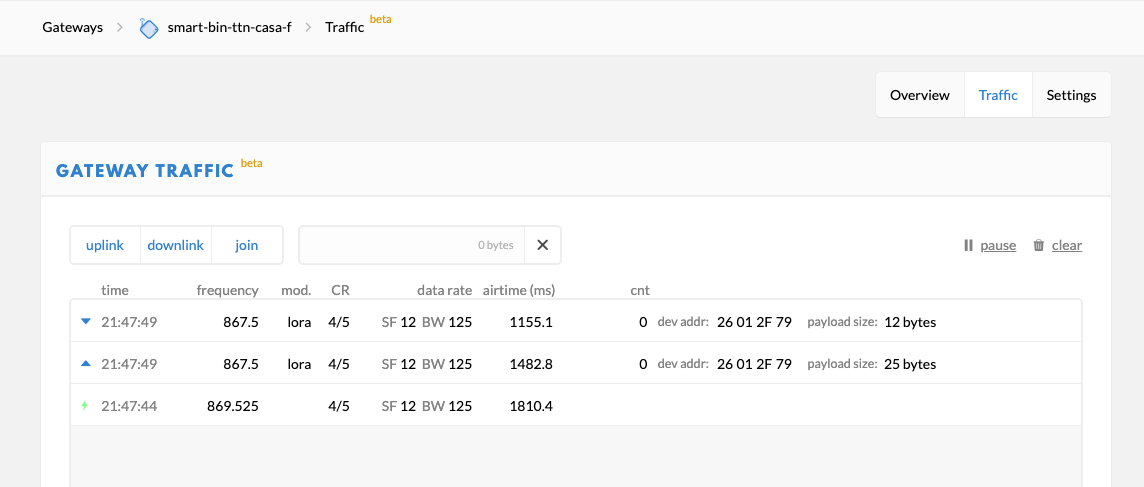

Yes, you can see in the image attached that the gateway seems to receive the raw packets from the TwasTe sensor.
The thing is that everytime I manually reboot the sensor, I can see the activation and uplink and downlink messages (in the application dashboard) and their counterparts in the gateway dashboard. But after these two uplink-dowlink messages the sensor seems to stop to transmit any data. 10
If you stop seeing any uplinks in the raw traffic page, that sounds like a bug in the sensor firmware.
It may only be doing joins and not suitable configured to send data.
