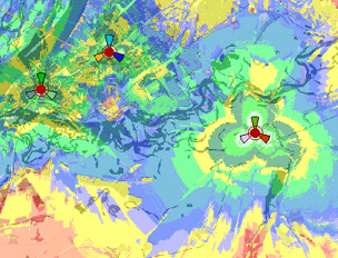

Hi, you might try this one. It is the only one I know of
http://www.atdi.com/lora-network-planning-and-sizing/

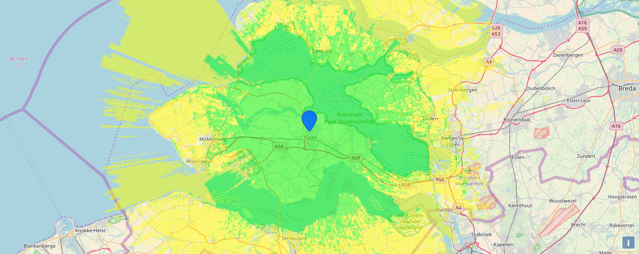

made with the use of the online tool
