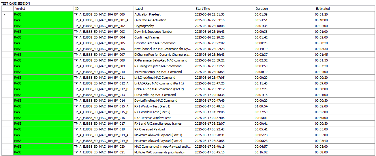

However, in my own opinion more excitedly, we’ve been long at work getting RadioLib (pre)certified. This process started in August of last year with the help of @kersing (thank you very much!!). I had already found out that writing a proper LoRaWAN stack is hard, but let me tell you: making it compliant was probably equally difficult.
Many test rounds occured, many emails and messages were exchanged with Jac, many hours spent staring at specifications and test cases, and last but not least the college where I work at is now an institutional member of the LA, in turn granting us access to the LCTT tool which allows members to self-test devices for pre-certification. With all of that, after 10 months and many major and minor patches, we now yield a PASS on all applicable test cases (see below what has been tested).
For more info on pre-certification and what this means for device developers, please read the RadioLib wiki page.
In short, RadioLib is effectively pre-certified for Class A operation on dynamic channelplans (EU868-style) for OTAA and ABP, with 8 active channels. I soon hope to test fixed channelplans (US915-style) as well, with an appropriate 8-channel gateway in shipping. Note that Class C is not pre-certified so far.
