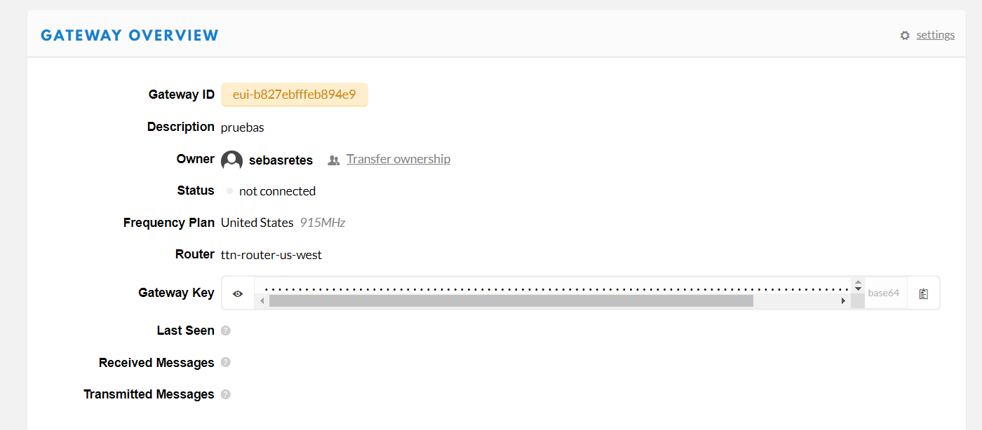

Hi, I am trying to connect to TTN my gateway, I have the RAK 831 Developer Kit in 915mhz, i am using the raspberry pi zero w and the original rak to raspberry converter board, I have followed 2 tutorials, this one: https://github.com/ch2i/LoraGW-Setup/tree/15f56e03546c6c5885b58259db64c0fa10af1250
And the one that is in RAK’s page: https://downloads.rakwireless.com/en/LoRa/RAK831-Pilot-Gateway/Firmware/
Non has worked for me, I registered in TTN, but never seems to be connected.ttn%20not%20connected
I also registered my Json file in the Github repository.
I would like to know if someone can help me to connect it to TTN, I´ve been reading and I think that is a problem with the Reset Pin or with the 915mhz band.
Thanks in advance guys!!!

I can see that you are trying to use US915, probably you need AU915, the frequency plan is not the same, and .json file differs, i make the same mistake initially.
What endpoints are you trying to connect? I used RN2903 from microchip and requires an special firmware to use AU915!!! Not the standard firmware from US915.
It´s very important to have all in the same frecuency band… Check with MAC commands what frequencies are using, enable the correct channels, check all at details, details counts!
I am using the US915 .json file too, I configured the gateway to use the US915Mhz in TTN.
Right now I am just trying to connect the RAK831 Gateway to TTN, I am not using a node.

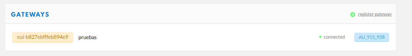

Hello again guys.
I followed the RAK’s tutorial:
After edit some code, I made it!
The RAK firmware is used for RPi with eth0, I am using a Rpi Zero W, what it means that I use wlan0 instead of eth0. So, the gateway ID can not be generate correctly.
I did some changes in /opt/ttn-gateway/packet_forwarder/lora_pkt_fwd/update_gwid.sh
I change this:
GWID_BEGIN=$(ip link show eth0 | awk ‘/ether/ {print $2}’ | awk -F: ‘{print $1$2$3}’)
GWID_END=$(ip link show eth0 | awk ‘/ether/ {print $2}’ | awk -F: ‘{print $4$5$6}’)
for this:
GWID_BEGIN=$(ip link show wlan0 | awk ‘/ether/ {print $2}’ | awk -F: ‘{print $1$2$3}’)
GWID_END=$(ip link show wlan0 | awk ‘/ether/ {print $2}’ | awk -F: ‘{print $4$5$6}’)
Basically just eth0 to wlan0.
After that I edited /opt/ttn-gateway/packet_forwarder/lora_pkt_fwd/local_conf.json
Changed the gateway_ID to the one that I have in TTN.
After that, my gateway seems to be connected:
