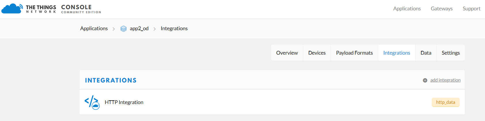

I use TTN I guess … image
I use HTTP integration from TTN, is there anything wrong if I want to share my access?
Thanks

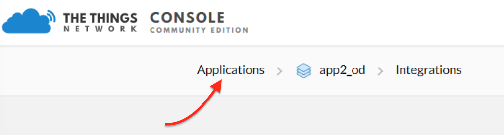

Okay, the HTTP Integration is not running on your gateway, and is not limited to just a single gateway. Instead, it’s assigned to an application, which will receive data from all TTN gateways that happen to receive your device’s transmissions.
application
You’re all set then. Any TTN-registered device that is close to your gateway will have its transmissions forwarded to their application.
