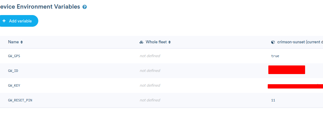

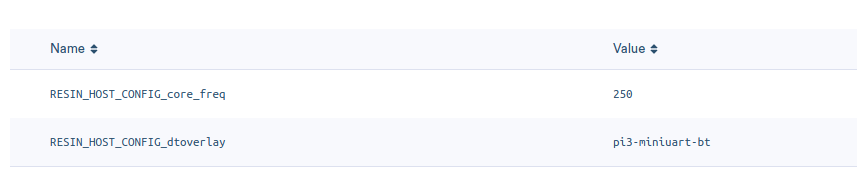

Settings in BalenaCloud:
Fleet Configuration:
Is the correct reset pin being driven?

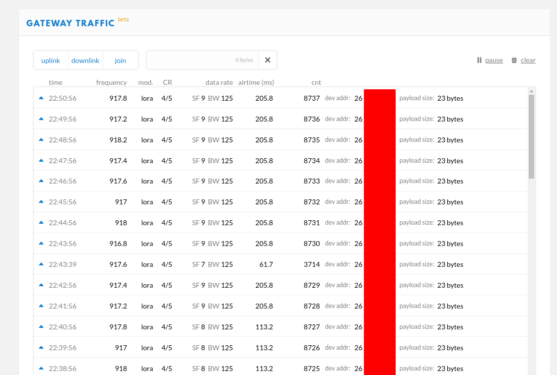

I’m seeing data showing up under the Gateway Traffic from my 2 clients, but it’s not getting through to the device console traffic.
Is that airtime correct?
There has been an outage which resulted in data not being delivered to applications. May-be that is what you are seeing?
Raw packets failing to become application packets typically have nothing to do with the gateway, rather they are either a node sending a packet with invalid contents (wrong keys, replayed fcount, etc) or infrastructure problems
No obvious reason to suspect it is not. Besides this is calculated server-side and has no real role in the success of the process, since RX windows are relative to the end of the uplink packet which is what the LoRa chip in the gateway actually reports. The airtime calcs are really only a view of how active a node is.
I think you might be right. With the original RAK software it’s also not working, both node devices have cut out at exactly the same time (19 hours ago, around 2100 hours NZ time)
Any idea when it’ll be back up or where I can find more info? https://status.thethings.network/ doesn’t show anything. Slack shows some people back online.
I’ve switched back from RAK to Balena install, and Gateway is showing up fine in TTN console, but both devices are still not getting anything through.
I seem to be getting huge numbers of packets hitting the gateway now. But no real data.

13.08.19 16:47:00 (+1200)  main  ##### 2019-08-13 04:47:00 GMT #####
13.08.19 16:47:00 (+1200)  main  ### [UPSTREAM] ###
13.08.19 16:47:00 (+1200)  main  # RF packets received by concentrator: 1559
13.08.19 16:47:00 (+1200)  main  # CRC_OK: 12.44%, CRC_FAIL: 87.56%, NO_CRC: 0.00%
13.08.19 16:47:00 (+1200)  main  # RF packets forwarded: 194 (4462 bytes)
13.08.19 16:47:00 (+1200)  main  # PUSH_DATA datagrams sent: 0 (0 bytes)
13.08.19 16:47:00 (+1200)  main  # PUSH_DATA acknowledged: 0.00%
You might as well get your own gateway to give you the raw data and decode it yourself, there’s little reason to depend on external services when the data is flowing through your own gateway.
Best case you get data even when the servers are unreliable; worst you discover something specifically wrong with your packets that prevents them from being properly decoded, and then fix that.
All operational issues are discussed on Slack #ops channel. If you are (still) experiencing issues you should mention them there.
However, are your gateway, gateway registration and application all pointing to the same region? (your gateway is using meshed so everything else should as well) If not you should change things to make sure everything is using meshed. TTN repeatedly communicated there are known issues with inter region communications that will not be fixed in V2 of the back-end.
The low-level library is getting valid (CRC is valid) packets from the hardware. These are forwarded to TTN. Does TTN show anything on the gteway traffic page?
The idea behind the community network is that you share your gateway with other users and other users share their gateways with you. Recommending people to implement their own ‘network’ is not in the spirit of TTN and takes resources away from the community network.
