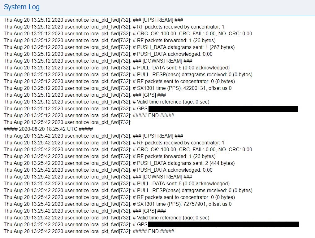

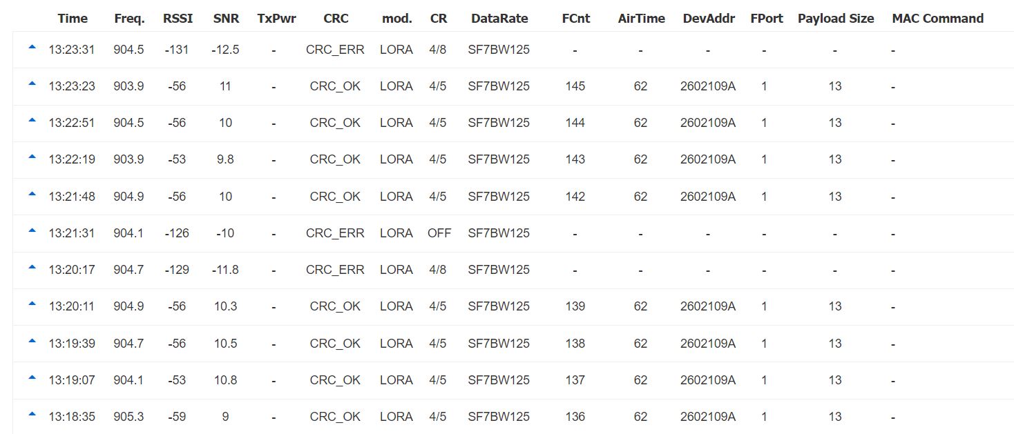

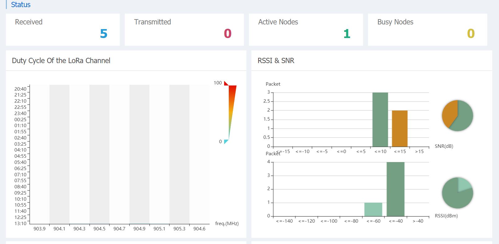

Thanks everyone. Here’s an update. I tested a node about 10m away from the gateway. When I log into the RAK gateway and inspect the status and packet page, I see packets coming in. For this test, I was transmitting every 30 seconds. On the Status page of the, it would gradually increase Received counts up to 5, then reset back to zero. I watched this through 4 or more cycles. However, on the packet page, it occasionally would transmit 15+ messages in a row without dropped signals. I’ve included a few snapshots in case that helps.

These images &log files from 7249 gui…can you share LoRa packet forwarder page and is LoRa server enabled or disabled. Also can you share the ttn gw console page?
That pull and push are listed as 0% acknowledged indicates that whatever the packet forwarder is pointed at, be that the name or address and port of an external network server or an internal one or bridge, is not answering with responses that get back to the packet forwarder.
I’d check that the server address and port are correct, and check that you aren’t behind some kind of odd NAT setup.
In terms of the received packet counts climbing up then falling, this is probably either because they are per evaluation period not total, or because the lack of responses is causing the packet forwarder to periodically give up and quit, and then a new copy to be run by the system.
You need to figure out if the configuration is correct, and why you aren’t getting acks to the push & pull operations the gateway is aiming at the server. While they can move data, the pull / pull ack is also a type of application-specific “ping”… and it is failing.

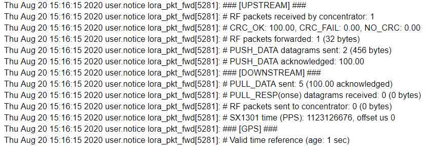

The LoRa Packet Forwarder server address was incorrect. I updated that to router.us.thethings.network and the GW is now showing on TTN. I’m getting 100% push ack. I need to dive a bit deeper into the setup docs provided to understand all of the other settings, but for now at least it is showing on TTN and registering the node packets coming through. Thanks!
