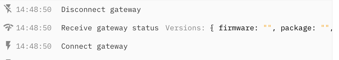

But it always disconnects within a second:

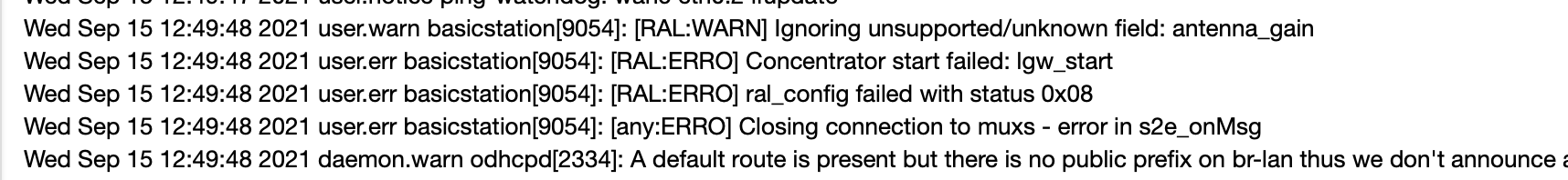

In the Gateway-System-Log it always says:
Could somebody help me with this error? I tried my best but didn’t find any mistake…

You could try to get a larger view of the gateway log, what you’ve captured doesn’t show any reason for failure.

Here is a larger view of the gateway log:

I’m seeing the same errors as @htshusum on my RAK7258. Months ago I moved my RAK7258 from TTN v2 to v3 (also switched from packet forwarder to basic station) and everything was working. Today I logged into TTN v3 to see my gateway disconnected with the same errors on the TTN console and the RAK7258 logs. Did TTN change something?
