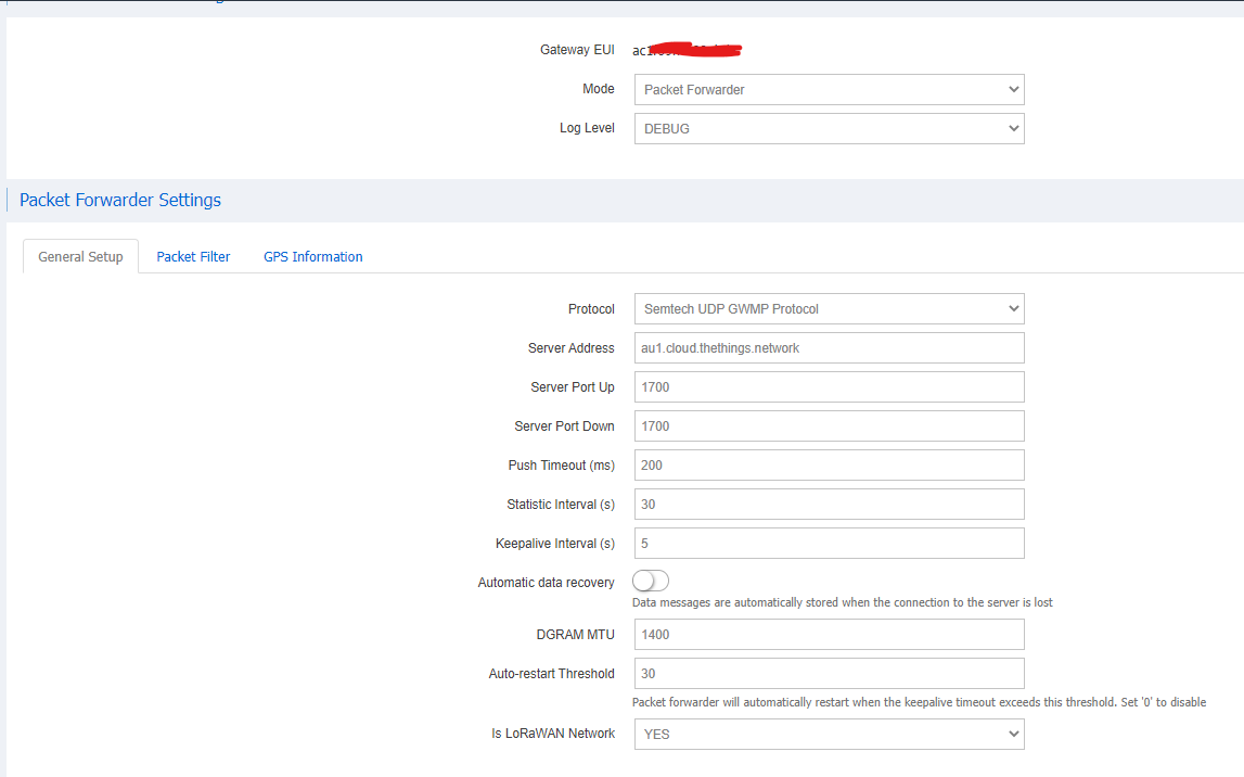

I’ve been trying to figure out why my AU915 RAK7258 gateway has stopped connecting to TTN. I’ve used this gateway before in the past and definitely know it’s able to connect to TTN, but now in the system log I see this error:
ERROR: [main] failed to start the SX1301/SX1302 concentrator
Checking some past threads, there isn’t really a clear solution on how to resolve this. Can someone please help me in understanding what’s actually going on here?
