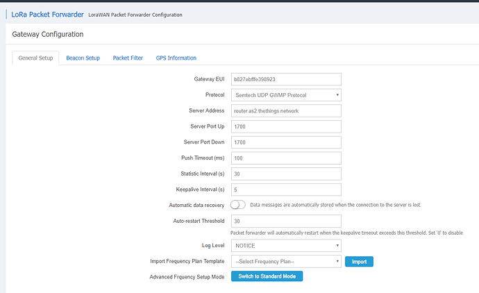

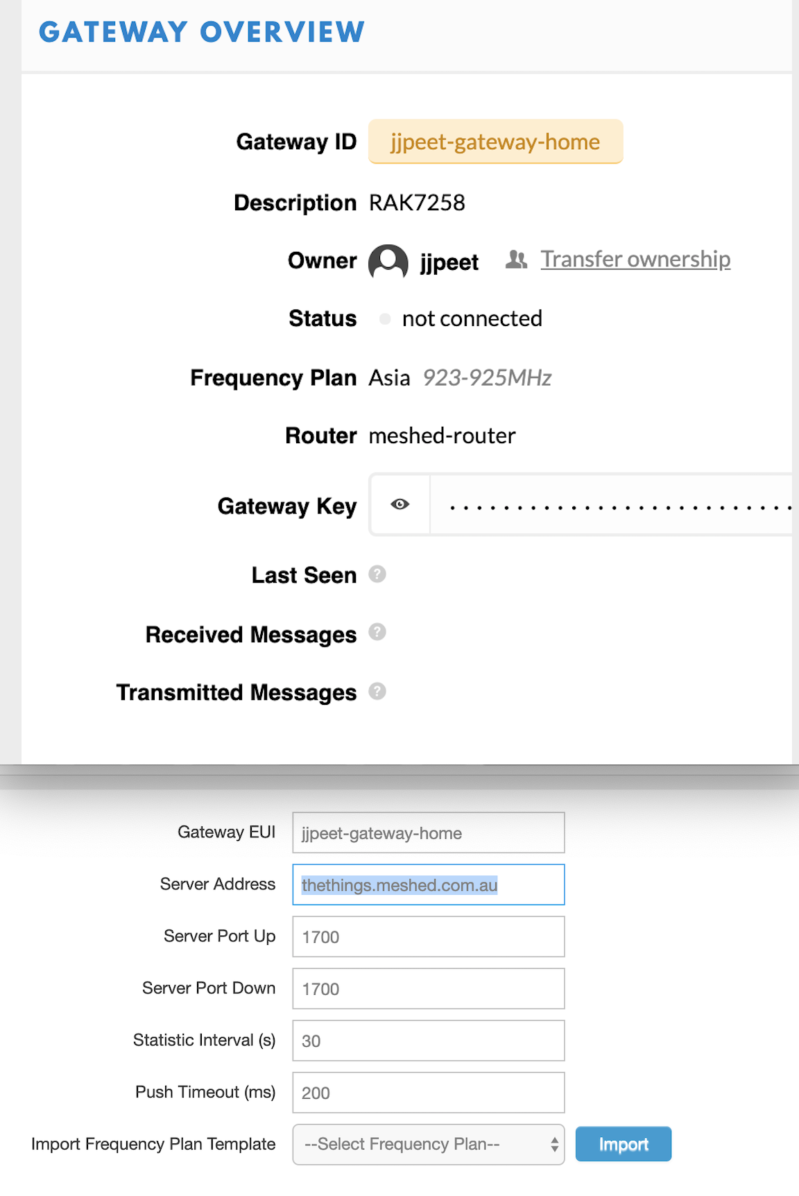

Below is an image of my TTN settings; and below that my gateway settings;
I have imported the AS923-925 frequency plan, and added in the server address. But I’m not sure what the gateway EUI is supposed to be (i’m assuming ttn gateway ID??) There are other settings too; but I’m assuming I need the basics to be right first? Also, where do I paste the gateway key (if at all)?
You have to check the legacy packet forwarder box when registering a traditional gateway with TTN. No gateway key is used.

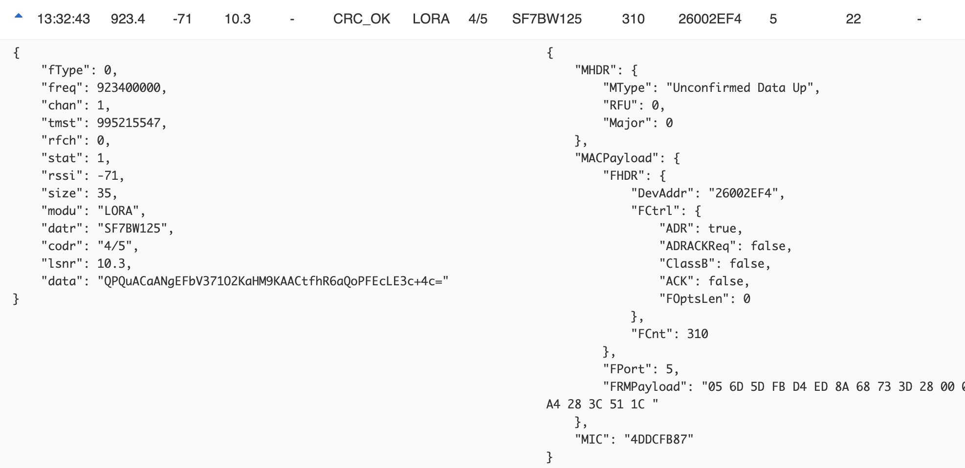

This is what I’m getting when a device connects and sends data. I’m assuming the RSSI data is what I should be looking at to judge the quality of the connection? Is that right?
