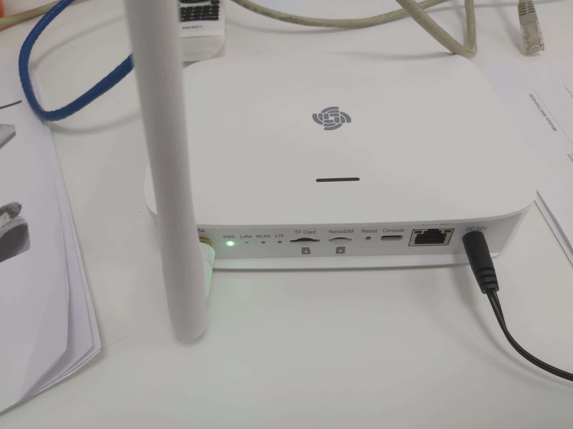

We have a Rak7268 Wisgate Edge Lite 2. At the top of that device, it has a breathing LED. This breathing LED is off and we can not connect it from any devices. We tried to reset, but it’s not working. Could you please help us?

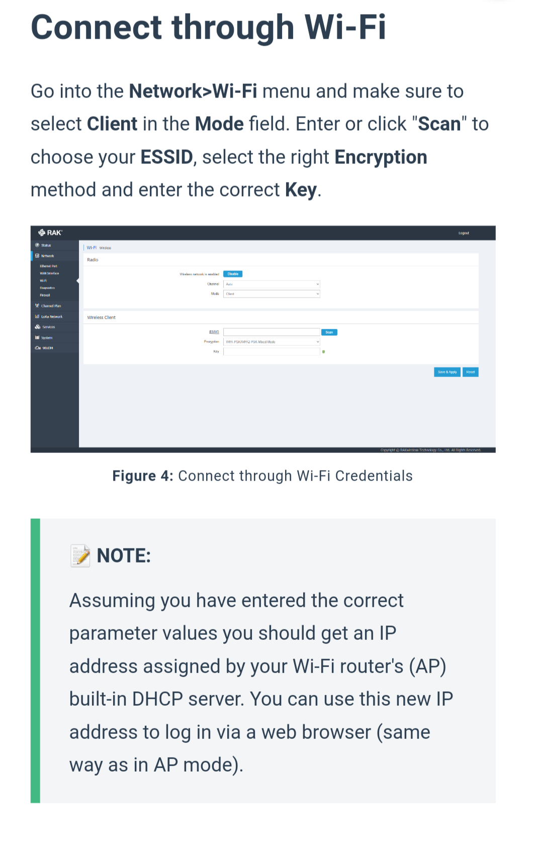

Thank you for quick response, sorry for misunderstanding @descartes @Jeff-UK, our RAK is not connected to public Wi-Fi, it is hard to explain but there is a public network, we got it to a new private network (I was tried to say that it was hard to reach with cables). Our RAK is using private network like we use in our buildings. Moreover, it is hard to get a connection with Ethernet because it is placed in upper room. We should use Wi-Fi connection to be online. We also tried with other routers, mobile hotspots and more, when we turn off RAK and turn on to it, RAK can not connect to router. RAK got a high signal, also tested to our other devices. We configured RAK’s configuration system, our client Wi-Fi saved. We expected that, if we turn off the RAK, it should reconnect to client Wi-Fi (private network). But no. We shouldn’t turn off the RAK, but if we had to turn off, our settings will gone because of resetting. 1 years ago, in TTN forum, some of people said that it is a bug. Is it normal or something wrong with our RAK?

We are using 1.3.4 version of RAK7268. We done this setting for Wi-Fi connection:
