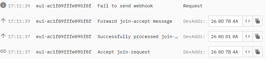

With the new antenna, I’m not getting the joining signal and no data
Every 10sec I’m getting this
for joining

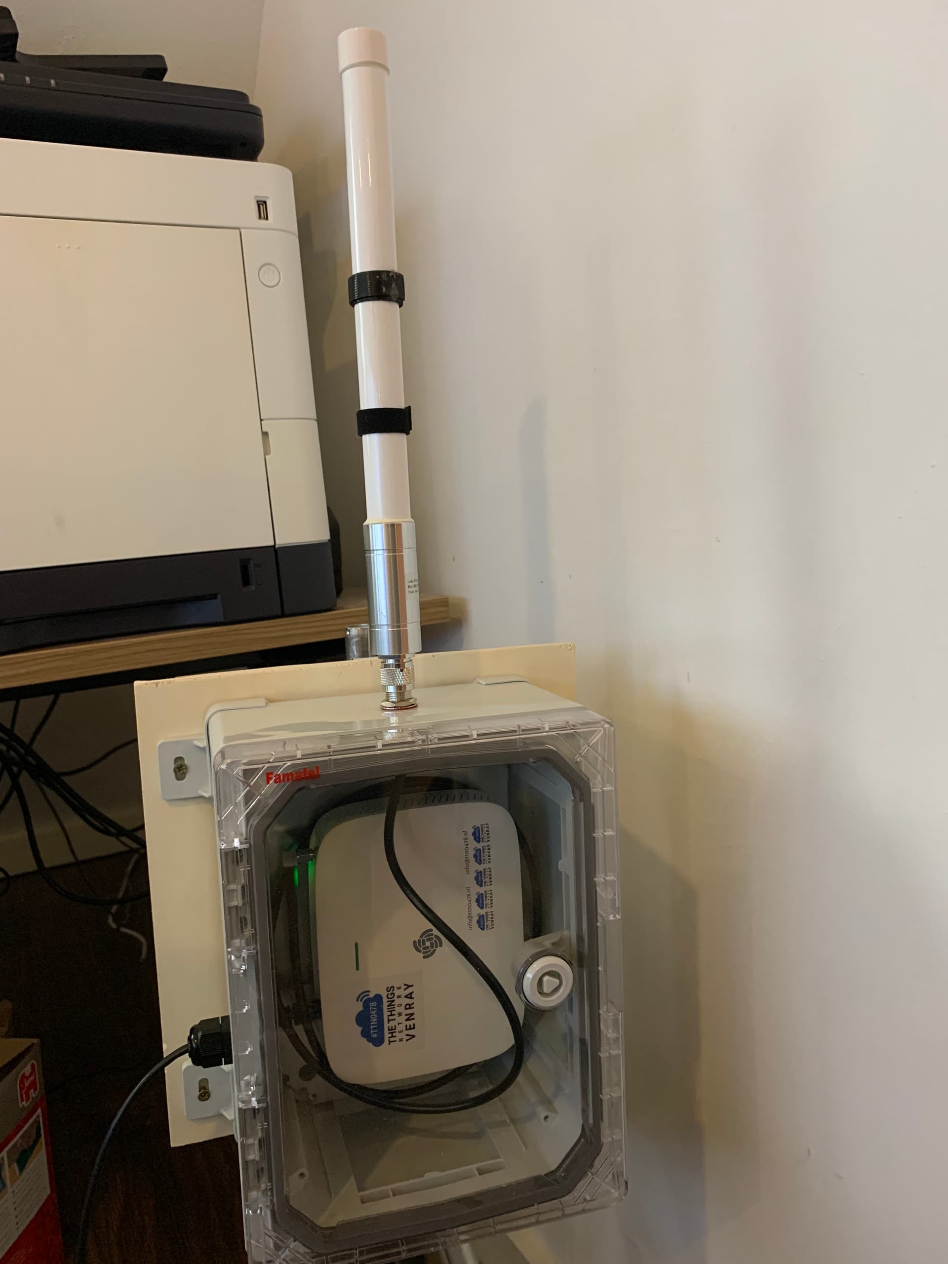

I have a 7258 and 7268 and connected a external antenna. I can change it with a 3 of 5.8 dbi. But I do not have any problem with both RAK 's on TTN.
I placed them both in a IP67 casing. I do NOT use both outside, but with this extra coverage I can place them anywhere inside where is a lot of dust etcetera
