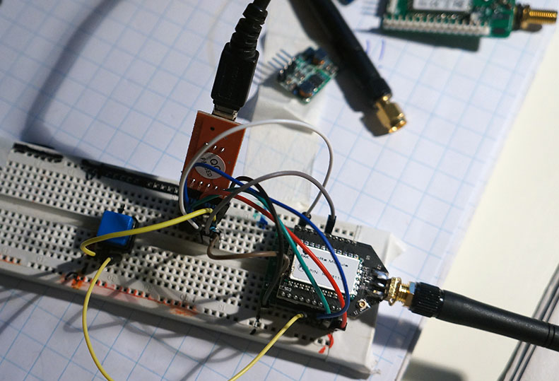

I have this module mounted on a breakout board bought from AliExpress. I have it connected to a linux pc via a ch341 usb to 3.3v uart converter. I’m using minicom, 115200,8,1,N.
When I apply power I get “Welcome to RAK811”.
When I try to enter AT commands there is no echo and no response from the 811. I have tried adding CR & LF in the minicom options to no avail.
I can even reflash its firmware using the ST flashing tool so that says that my connections are OK.
This should be simple, what am I missing?

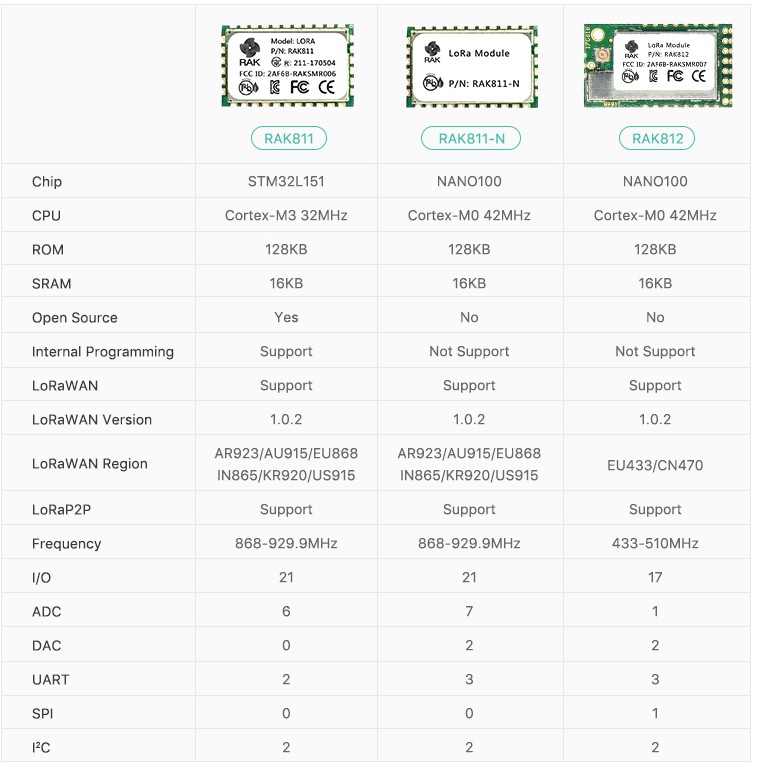

difference between 811 and 811-N series

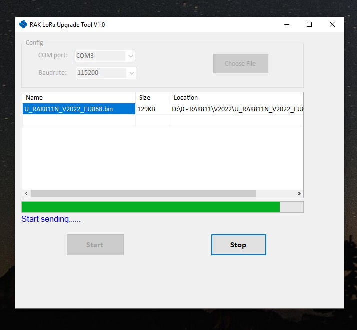

first I updated my rak811-N with firmware V2022
info and tool> http://www.rakwireless.com/en/download/RAK811-N/Firmware%20upgrade
that went smooth, just be carefull you select the right bin file

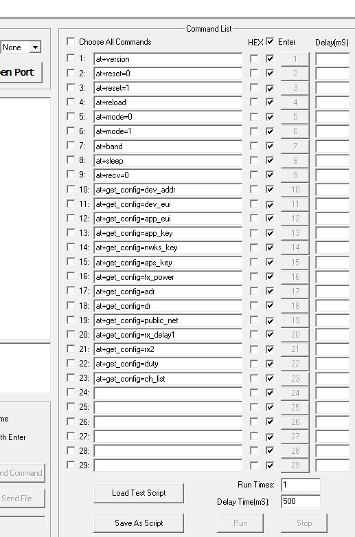

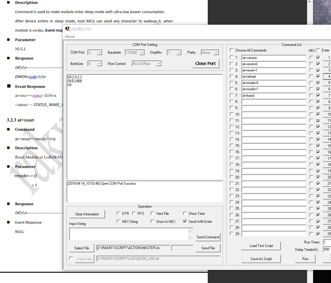

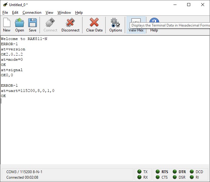

after updating connected to usb-serial sending some AT commands
to make testing (behaviour) more easy I’m programming 'function buttons and writing some testscripts
the results can be used to write an arduino sketch , or other mcu, later to control this module
