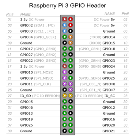

Here GW_RESET_PIN actually refers to the PIN number (just like te name indicates, which is correct) and not the GPIO number.

The Reset Pin is asked by the main setup script and it’s the BCM format (GPIO Name)
To prevent (more) possible confusion:
Which is the GPIO number, not the GPIO name (because that would be something like “GPIO17”). ![]()
For
- CH2i RAK831 reset pin is GPIO25 (Pin 22) enter in setup script
25 - CH2i iC880a reset pin is GPIO17 (Pin 11) enter in setup script
17
but if you chose the correct board, setup does this for you
- RAK Raspberry Pi Adapter board for RAK831 uses GPIO17 (physical pin 11): GPIO number: 17
What does selecting?:
- All other models
Added ![]()
This mean you’ll need to enter the reset pin manually in the setup (and may be manually adjust some config)
