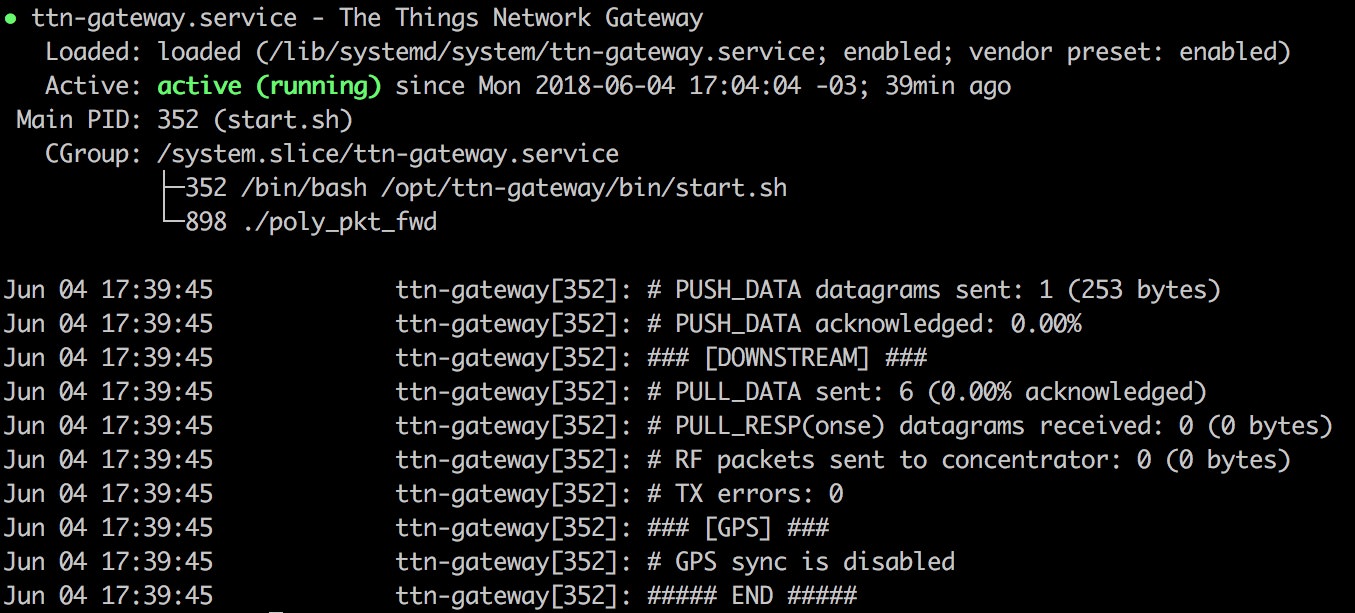

After rebooting I check the logs of the and everything seems to be running the way it should, see the screenshots:
sudo service ttn-gateway status returns
As you can see there is no confirmation from the backen to my GW

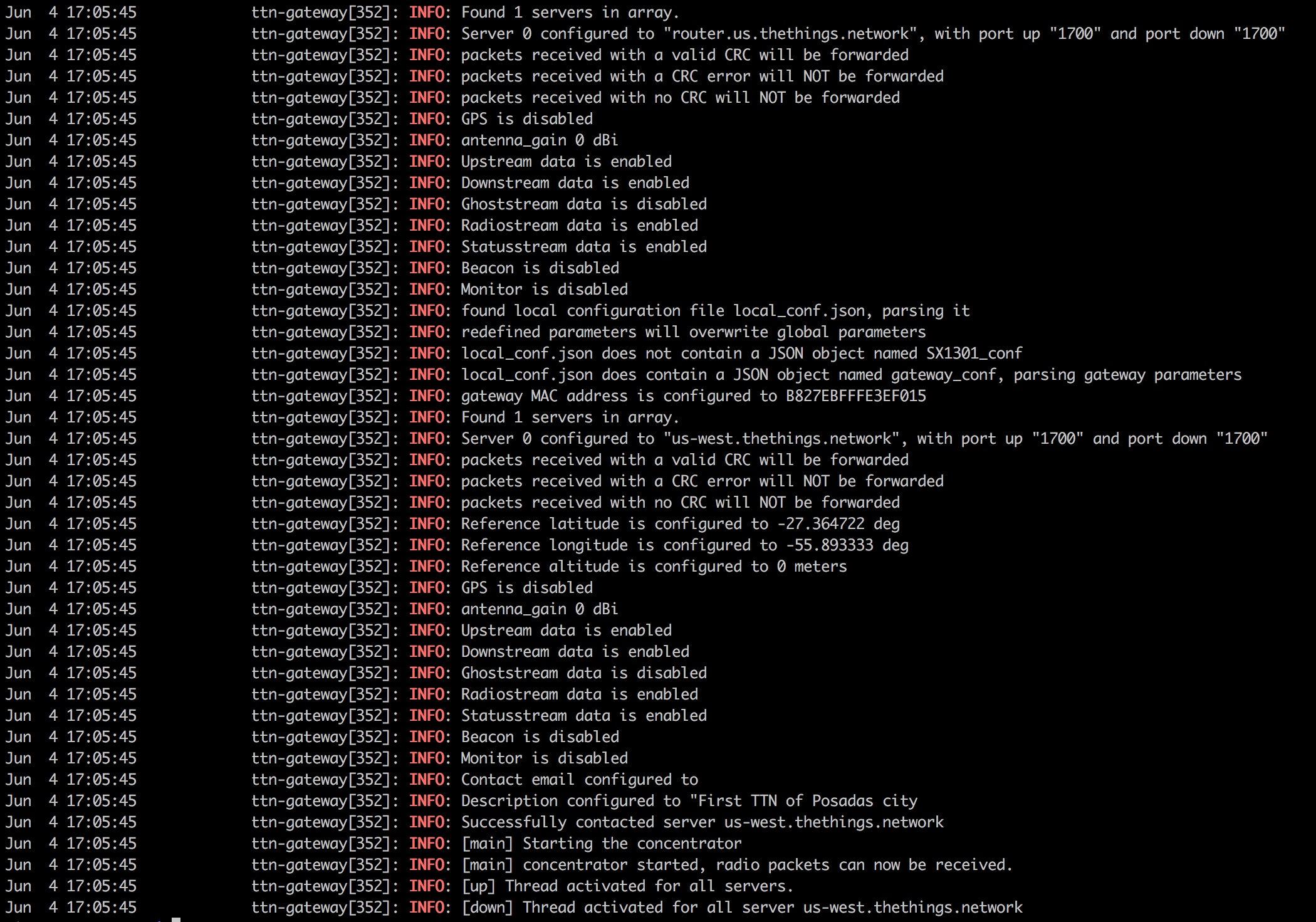

and if I execute
cat /var/log/syslog | grep INFO
I am pretty sure that I did the right steps to make it run, and I still see “not connected” in TTN’s console.
