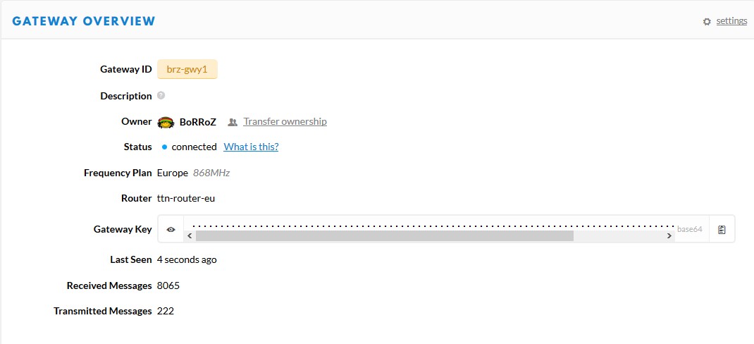

I registered it in the TTN console -> status connect and seems to be working ok.
? What is the expected value “last seen =” ?

if your gateway is seen by the backend (registered) this value will increase from 0 to 30 seconds
so every 30 seconds there is contact with the 'mothership

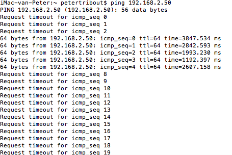

Here is a image of the problem when I work via Wifi
If I plug in the ethernet cable then everything becomes normal, I can connect via SSH and diagnose looks normal. -> linux command ‘top’ shows normal CPU 1,5% load
I can also ping the wireless interface without any problem <1ms.
If I unplug the ethernet, I can’t ping or SSH the wireless interface anymore.
But strangly the Gateway seems to remain working; accepting and forwarding lora node traffic to the TTN backend and the Gatway seems normal in TTN portal + refresh connection
