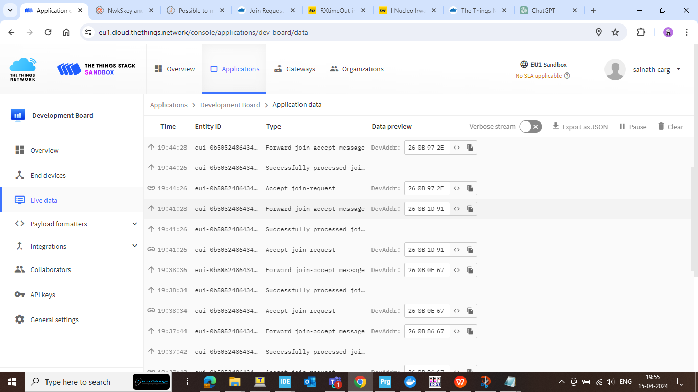

I’m using a MultiTech gateway along with the STM32WB5MMG and STM32L072 Discovery Kit boards. While the join request to the TTN server is successful, the end node is displaying an RX timeout. These logs are from the TTN end devices. Could you please provide guidance on this?
How far apart are the device and the gateway?
it is near by device with 10m
Point to start to try and fault find (Most common discussion point on the forum)
What is the RSSI?
Your node most probably are suffering from channel bleed, it needs a plaster :slight_smile:
