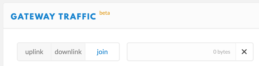

Last two hex numbers of what? The device address will change on every OTAA attempt so filtering on that will not work.
Also, one can filter on Join (disable uplink and downlink by clicking those):
traffic filter
on the EUI that is written on the device.
