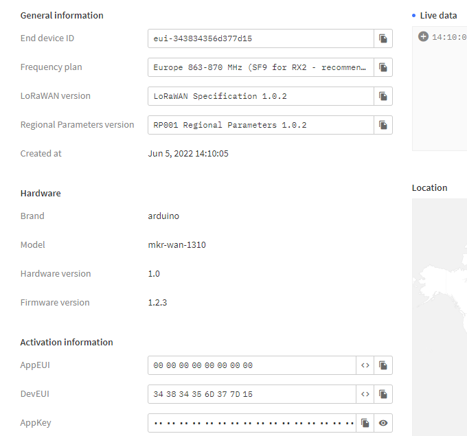

Did you also make sure the order of the DevEUI is correct (should it start with AB? Or is that A8? I can’t read the screenshot at 100% and when zooming the text becomes blurry)
And did you enter the correct AppKey on the device? (Or copy it from the device to the console)

Join EUI : 00 00 00 00 00 00 00 00 DevEUI : A8 61 0A 33 34 3A 7D15 Data rate SF7BW125 SNR : 10.2 RSSI -54

  • EUIs do not match. As the gateway traffic shows them you can easily compare with the setting of the node. In this case DevEUI in the gateway traffic does not match DevEUI in your screen shot so that is the first thing to correct.

The end-node screen shot shows a totally different DevEUI than the one that the device reports, so that will be your mis-match. The DevEUI isn’t even a TTI one so I’m not sure where it came from.
