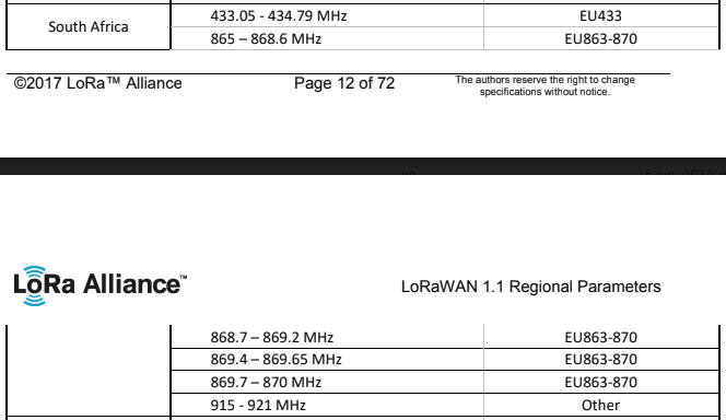

This is the recomendation from LoRa Alliance
I recommend using EU868, nobody is using 434MHz for LoRaWAN or for other modern networks
Sigfox also using RC1 = 868MHz
I have to agree with @nestorayuso here. Nobody is using 433MHz for LoRa. If you however do feel that you want to go that way, it defeats the point of using TTN, and you can just as well run your own private network.
868MHz equipment is just as available, if not more available, than 433MHz equipment. Also the antenna size on 868MHz is nicer for small sensors.
I however do not rule out 433MHz at all. It is something that is still on my want-to-do list. The trick is getting a global frequency plan set up that has at least one channel overlap in all regions. Then one can add extra channels per region, which can be dynamically configured into a device at join.
