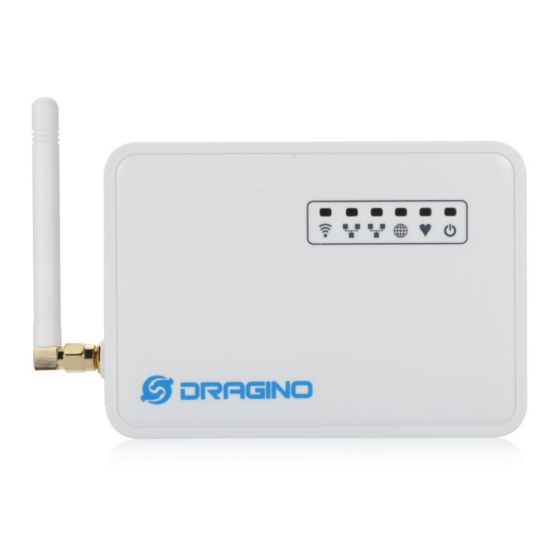

Long time diverted to activities with higher priority,
now dusting off my LPS8Gateway for setup of interface to TTN_v3.
Power Supply defective, but that easy to remedy.
Red LED for power now on and blue LED flashing near Globe-symbol,
but no access possible through the IP-adresses originally set.
Reset by long press on Toggle-switch does not make any difference:
  • no change for the 2 LEDs
  • no appearance of ‘own’ WLAN, nor any IP-address upcoming on the local WLAN or LAN.
Hint appreciated how to get revived access the Gateway.
[Not yet tried to get access via the Fallback-IP]
Today also tried the way-out by means of Fallback-IP, but no luck …
No response from the LPS8 on any testing on IP-adresses or on ports in the range indicated in the manuals.
As indicated in red text in the manual, it is possible that Fallback_IP has been disabled (explaining why no reaction), but doubt very much that such setup is the case, because LPS8 was only used for initial, experimental setup for interface between sensor and TTN_v2.
Would also expect that Reset would re-enable this Fallback_IP.
Unless somebody knows a tric to enable Fallback_IP on this apparently ‘locked’ LPS8,
there seems no other conclusion than ‘end-of’very-short-life’ for this LPS8 and the need to purchase a replacement Gateway.
What do Dragino suggest?

  • LED for Power on LPS8 is continuously on in combination with LED flashing on the PowerSupply, with rythm of flashing and level of light dependent on how the microUSB-connector was in the housing of the PowerSupply
  • LED of LPS8 is out when the LED on the PowerSupply is continuous.
    => might be sign that USB-interface/connector at side of PowerSupply is wobbly/defective
    Using an alternative PowerSupply (elsewhere proven to be OK) gives LPS8 a steady Power-LED and flashing LED for ‘Globe’, which seems a sign that power entering the LPS8 now OK…
    But next testing the various options for access to the LPS8, no entry found:
    if no remote entry in view, what to ask from Dragino.com?
Not seeing any other signs of progress after various testing, tend to agree with Jeff that possibly the circuitry of the LPS8 has been hit and/or damaged.
Now checking the PowerSupply circuits within the LPS8, which has to be done most careful, not having schematics and considering the narrow traces => takes time.

This morning executed Gerben’s suggested approach for reset.
Has some different effect, because at power-up I see all LEDs flashing,
but then followed by ‘dead’ silence with only the red ‘Power’-LED on, and no further activity seen:
  • Checking with IP-scanner at (W)LAN, no signals looking like LPS8.
  • With WiFi-scanner no signal looking like LPS8.
Subsequent Power Off+On results in same situation as after other power resets:
red ‘Power’-LED steady on, and blue ‘Globe’-LED flashing.
=> Those other LEDs flashing at Gerben’s way of reset seems sign that still life in the LPS8,
but not yet the proper procedure.
No other approaches in view => ideas for reset/revival exhausted
=> Dragino has been contacted.
