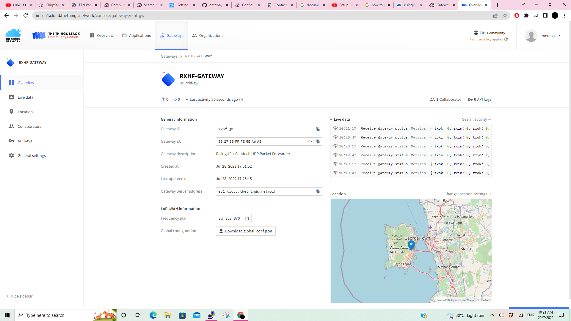

Hi everyone, currently we are working with the ttn. Now I’m in the middle of registring my gateway to the TTN dashboard. However, when i register my gateway it shows disconnected.
So this is my log:

I’ve been trying all the solution in this forum but none of its work. So, what is exactly the problem is? Please help me…
