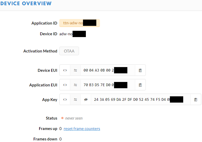

First of all, I created the Application and a registered device on the console.

mac set appkey 243A0569DA2FDFD0524574F5xxxxxxxx
ok
- Set the AppEUI
mac set appeui 70B3D57ED0xxxxxx
ok
- Set the DeviceEUI (= hwEUI)
mac set deveui 0004A30B00xxxxxx
ok

After that, i want to join OTAA
mac join otaa
no_free_ch
but as return value i get allways no_free_ch!
Can somebody give me a hint what’s going wrong?
