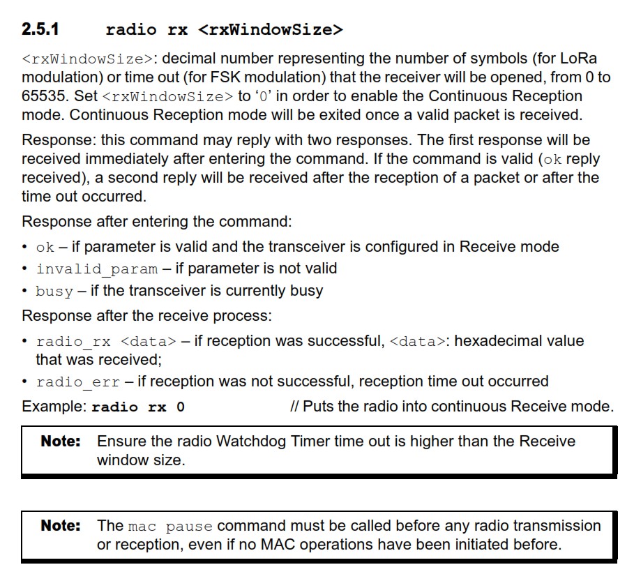

When I send an rx command to the Rn2903 with a rx window, it seems not to be milliseconds. For instance, if I give it a command like “radio rx 1000” it comes back with the timeout radio_err in about 16 seconds instead of 1 second. I have the wdt set to 0 for this test. However, if I set the wdt to say 2000, then I do get the radio_err back in 2 seconds. So the wdt seems to be correct, but the radio timeout is way off.
Can anyone shed light on this?
rncomm
see the 2 notes
Yes, I already complied with those notes. The wdt was 0 = infinite, and I had sent a mac pause command. If I give a finite wdt that is higher than the rx timeout, it acts like the wdt is the radio timeout as I mentioned in my example.

as stated its not in milliseconds but the number of symbols … for LoRa.
I wondered about that, what does that mean, the number of symbols ?
the number of symbols also depends on the spreading factor.
Thanks for clarifying. Probably in actual usage for me, I will just check what the timeout needs to be, given the spreading factor I am using - with a little trial and error. I guess the PIC coders of the RN2903 didn’t want to have that code do the internal calculation so a user like me could just expect a number of ms. Maybe it would have been too much code for their available memory or the time they had.
