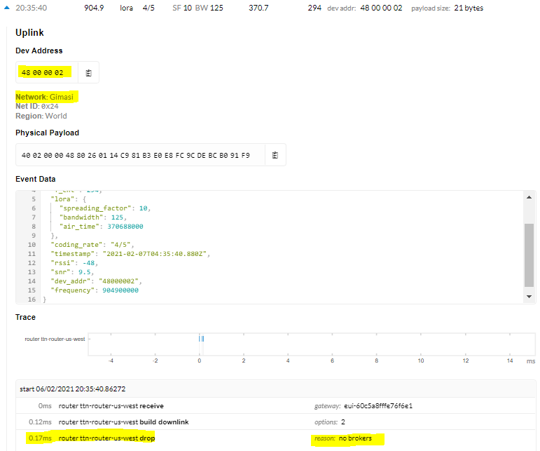

The gateway is connecting to the TTN console but in traffic, it’s reporting “router ttn-router-us-west drop… reason: no brokers”. The devices are showing as ‘never seen’.
I understand that TTN is dropping the packet because it’s not being recognized as a TTN gateway. The Dev Address is showing as 48000002 - which is not a TTN address and the network is showing as “Gimasi”, a Swiss provider that I’ve never heard of. I’ve done a factory reset of the gateway - no change. Is it a matter of changing the Dev Address? Can I do that? Thanks
Dont think this is a gateway issue - its your node not configured for TTN. TTN back end system doing what would be expected and dropping a device it doesnt recognise - note GW’s are largely unthinking devices - they hear all LoRaWAN packets in range and forward to the registered back end - in this case the TTN LNS. It is then down to to the LNS to accept or reject the message as is happening here.

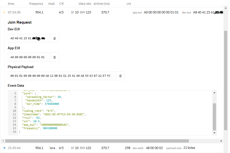

I’m seeing join requests in the traffic:
Are you seeing join accepts? If not the appkey is probably mis-entered
No join accepts. It could well be the appkey. I’ve re-entered and am waiting to see more traffic.
I’ve been focusing on the gateway all this time.
Got it! I also reset my device and just received a join accept. Dev addr is now correct and it’s showing the correct network. Thanks!
