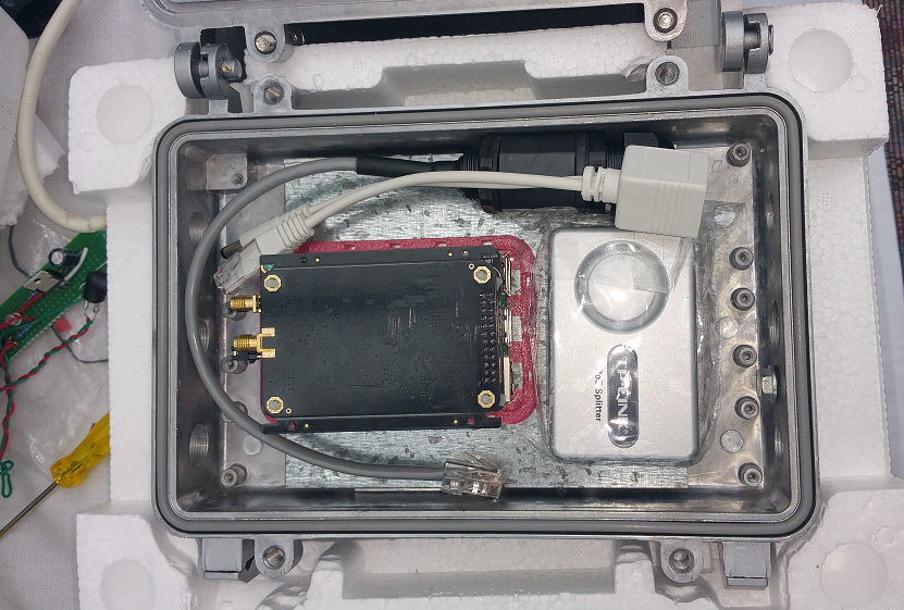

raspberry pi with RAK converted board along with RAK 831 concentrator, sitting on top of each other, will this fit inside the EZ-DCE15 ? will there be room to put in a heat sink ? It would be great if you can share your outdoor RAK 831 setup.
I went to http://www.e-zy.net ](http://www.e-zy.net/) but there is no buy option for EZ-SOE01W.

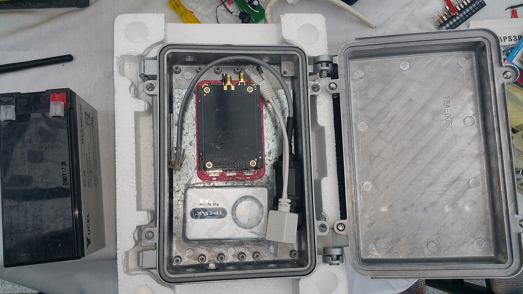

@myttndel Sorry but dont have a built unit to hand at the moment (all in the field!) But quickly threw a few components waiting next build into case to give you some idea of scale and space. In this case its Pi with RAK831 & RAK i/f board all mounted on a 3D printed raft to ease fixing to back baseplate. A build with ic880a would be approx similar in size depending on your choice of inter-poser board. If space tight for you you can remove this plate to gain a few mm extra depth. With this I have approx 1cm-1.5cm space to other side of case - you could perhaps look at (electrically insulated?) heat-sinking arrangement/gasket to take heat from the RF board to case, though I havent run into any heat problems so far. I build with either active or passive PoE feed, though also awaiting some small mains psu’s to test for on grid builds - would take space of the TP-Link unit here. There is even enough space to build in a small back-up battery for occasional short pwr outages.
Edit original 2nd pic was duplicate…correct open view!
