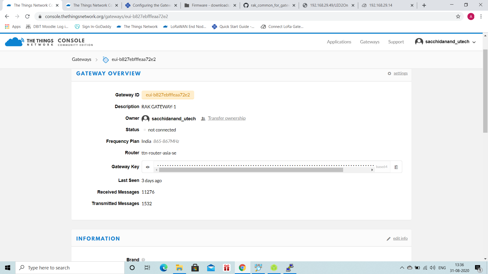

My RAK 2245 PI HAT based gateway is not showing up on the network(it says last seen three days), i worked on it on friday and just reconfigured the image file of RAK2245 to be sure, but it still shows last three days ago.
Please any suggestions?

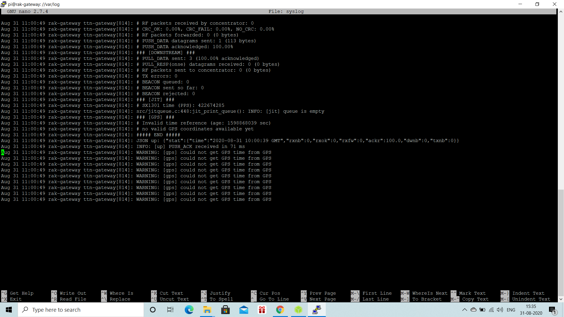

Check the gateway log file.
I have checked the log file and there is no logs after 11
please go through it once
what can be the problem?
And you can of course try to debug the issue yourself by reading the logging. Don’t expect us to invest our time when you just post screenshots and don’t tell us what you investigated yourself.
Sorry for the mistake i made, The gateway was running but it was just not showing on TTN console as connected.
I say the gateway was running because when my End Node sent the data it was received by both the gateways that i have, i saw this in the application console of TTN.
The final post yesterday was of around 3 pm Indian Time and the logs were of 11 am Indian Time, I restarted the packet forwarder again today and I saw the gateway as connected on TTN.

Keep in mind logging on the RPi might well be using UTC and not Indian Time.

The status of a gateway in the TTN console is relatively meaningless (especially the absence of any node traffic it is likely to be misleading); that you saw traffic from a device reported through the gateway is what mattered.
Note that your log from the gateway itself shows protocol acks being received, this means that the gateway is in fact in communication with the first level of the TTN server infrastructure.
