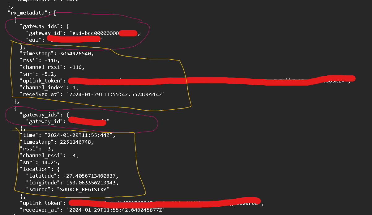

Why my 2 live data shows the same frame counter but different rssi value one with strong rssi and other with weak rssi value. and the time is same for both?
I guess two different gateways received the same message, one with strong RSSI and another with weak RSSI. The network de-duplicates the message but still shows in the uplink data that it was received by two dfifferent gateways.
Can you show a screenshot so we know what you are seeing and asking questions about? Now we can only guess.
Anything else not withstanding RSSI = -3dbm for 2nd entry WOW!..just WOW! Where on earth do you have the node wrt gw - inside same case!!!
Seperate and get down to -65 to -105 for sensible debugging likely seeing same signal bleeding over
Search forum for seperation recommendations when debugging. -45/50 to -115/117 likely ok inoperation depending on SNR SF etc. BUT -3 MEANS HAVING A SHOUTING MATCH WHERE NO ONE HEARDS PROPERLY AND EVERY ONE ENDS UP DEAF!!! :wink:

Please post text as text formatted with </> - black background, white text, yellow & red - it’s not very eyeball friendly at all.
