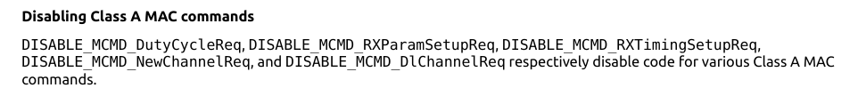

Only this much information is given in the README.md of the library. I have also gone through the library documentation but found no command related to RX window timing setup. Also, the timing section of README.md is difficult to understand for a beginner. Kindly tell me where I need to make changes for RX window enlargement/reduction.
