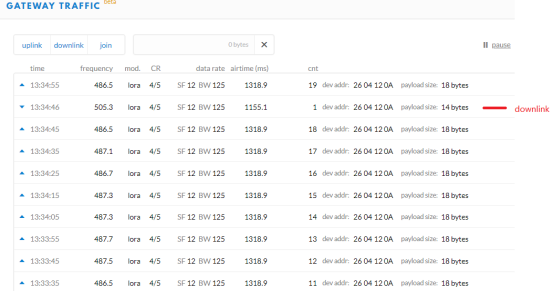

505.3 - SF12BW125 (RX2 downlink only)
2、Is RECEIVE_DELAY2 under the RX2 frequency under the TTN platform fixed at 2S or something else?

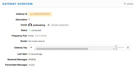

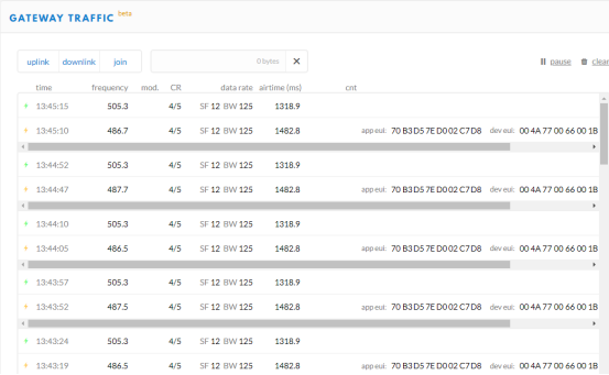

Where did you get that list? If the list you’re showing matches the TTN documentation, then: yes, of course, so RX2 will be using 505.3 SF12BW125, like you can tell from your own screenshot below. If your list is different, well, then TTN is not using that. You’re the only one having problems with the devices and gateways you don’t want to give us any details about. You might want to try joining at a better data rate (lower SF). The problem is in your secret setup.

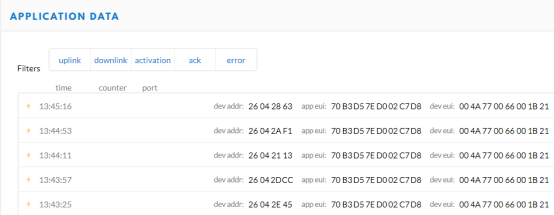

Following the standard, that’s 1 second for RX1 and 2 seconds for RX2, except for an OTAA Join Accept, for which it is 5 seconds for RX1 and 6 seconds for RX2. If you read other topics about that then you’ll see that the 5 seconds in your screenshot from one of your many other posts is to be expected for RX2, if that’s what you’re wondering about. See Join Accept transmitted after 4 or 5 seconds, instead of 5 or 6?

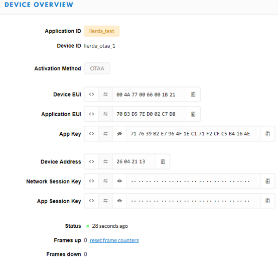

Like I linked to earlier: devices not receiving the Join Accepts has been discussed many times before, and asking again is useless. If you want help for your specific case, then you’ll need to give us a lot more details 1) about everything that once worked and everything that still works, 2) about what you tried in the past three weeks, 3) about all your hardware, and 4) about your setup in TTN Console, for applications (including the selected handler), devices, and gateways (including the selected router).
Maybe it arrives too late at the gateway, due to large network latency. What handler are the applications registered to? What do the gateway logs tell you? All your gateway traffic shows SF12; can you try to use a better data rate? (SF10 or lower increases the chances that TTN will use RX1 rather than RX2. Of course, both RX1 and RX2 should work.)

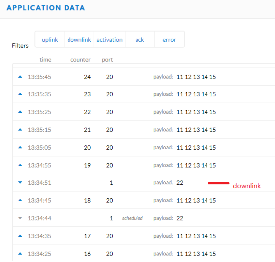

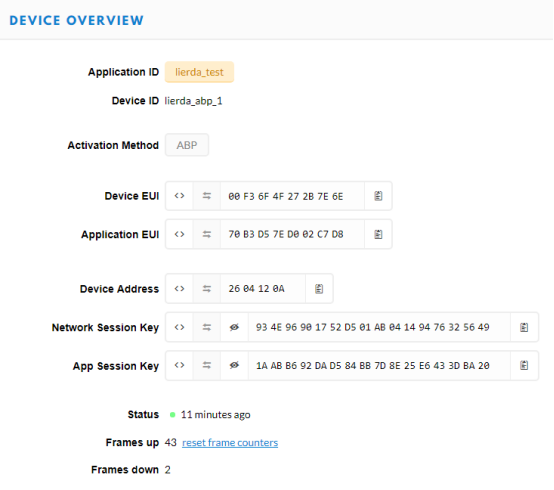

The sole facts that the ABP device’s downlink does not work, and that the OTAA join does not work, do not prove that the problem is related to sending the downlink to the gateway. Maybe the downlink arrives at the gateway perfectly in time, but the gateway does not support the settings that TTN wants, like see ERROR: Packet REJECTED, unsupported RF power for TX - 24. Or maybe the gateway is actually transmitting it just fine, and the node’s timing is not sufficient accurate. You cannot tell unless you can peek in the logs of the gateway or do some actual measurements using an RTL-SDR dongle.
