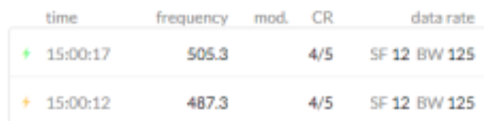

Where did you get that list? If the list you’re showing matches the TTN documentation, then: yes, of course, so RX2 will be using 505.3 SF12BW125, like you can tell from your own screenshot below. If your list is different, well, then TTN is not using that. You’re the only one having problems with the devices and gateways you don’t want to give us any details about. You might want to try joining at a better data rate (lower SF). The problem is in your secret setup.
Following the standard, that’s 1 second for RX1 and 2 seconds for RX2, except for an OTAA Join Accept, for which it is 5 seconds for RX1 and 6 seconds for RX2. If you read other topics about that then you’ll see that the 5 seconds in your screenshot from one of your many other posts is to be expected for RX2, if that’s what you’re wondering about. See Join Accept transmitted after 4 or 5 seconds, instead of 5 or 6?
