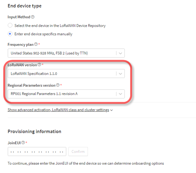

@bluejedi Thank you, wonderful, read through it, only question I have before testing is what values to plug here. The instructions don’t specify the exact steps for adding the end device to the console?
Whilst LMIC-node provides the framework, the foundations are built on your choice of the LMIC library - which you need to look at the docs so you are get such details as the LW version.
@descartes Hi, I’m using MCCI LoRaWAN LMIC library as suggested by @bluejedi https://github.com/lnlp/LMIC-node
I haven’t kept up with the latest changes recently, but as far as I’m aware a safe choice is to select version 1.0.3 for both LoRaWAN and Regional Parameters.
I’m not sure I understand your point. You are using a wrapper that makes implementation much simpler, but you choose the engine.
As you know what the underlying stack is, you can read the implementation information for it to make the appropriate choices.
