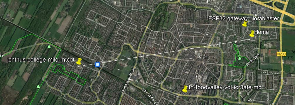

In you area there are 2 other gateways besides yours.
ttn-foodvalley-vdl-icr3ate-mc
  • On v2 but will still forward your data
    -1.5km away from your “home”
  • I am not sure if it is indoor or outdoor
  • Last heard at 2022-02-18T14:03:01.555667Z
ESP32-gateway - lorablaster
  • On V3
  • 300m away from your “home”
  • Last heard at 2022-02-18T14:13:45.793765
