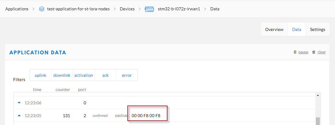

Received uplink from stm32-b-l072z-lrwan1
MSG(app_id=‘test-application-for-st-lora-nodes’, dev_id=‘stm32-b-l072z-lrwan1’, hardware_serial=‘3435313160379011’, port=2, counter=131, confirmed=True, payload_raw=‘AAD4APg=’, metadata=MSG(time=‘2020-05-29T10:23:05.019674139Z’, frequency=868.3, modulation=‘LORA’, data_rate=‘SF7BW125’, airtime=51456000, coding_rate=‘4/5’, gateways=[MSG(gtw_id=‘eui-0080e1ffff015232’, timestamp=1749644820, time=’’, channel=6, rssi=-57, snr=8.8, rf_chain=0)]))
I need in the file the time, the dev_id and the payload (even if is different from payload that I see on the things network)

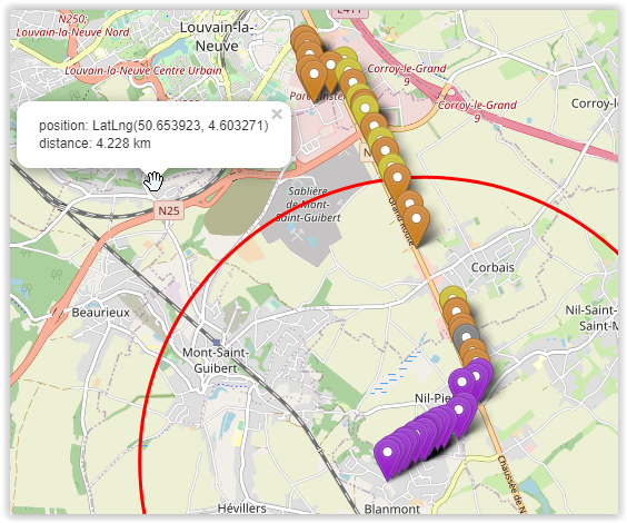

As examples found here and there are most of the time bullshit or not working directly without heavy re-coding, I give you a real working code that I use for my lora tracker.
Combined with a website which read the json file generated by this python script, I obtain this:
