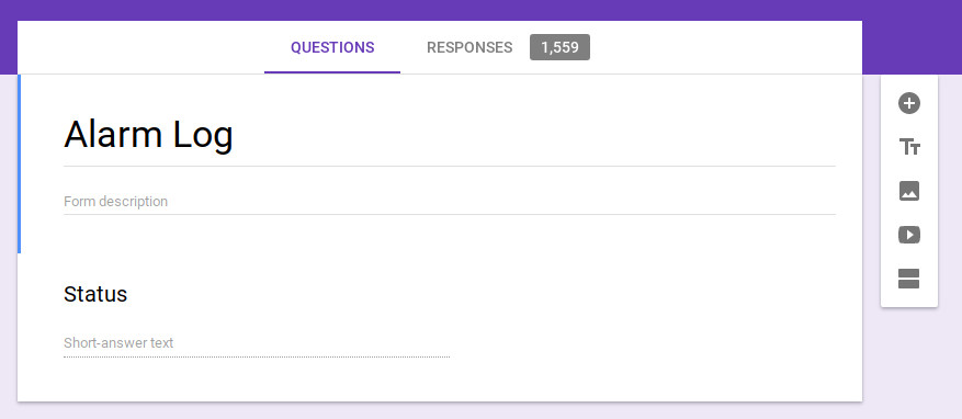

The way I did this is as follows:
  1. Open Google Drive
  2. Using the “NEW” button, drill down until you find “New Form” and create and name a new form
  3. Now design your form - The text of each question(eg “Sensor 1”) will be the header of each data column in your table

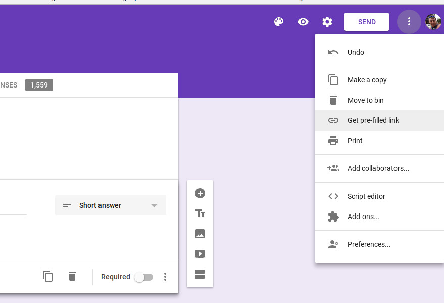

  3. When done click on the top/right of the page, click the three dots to drop down a contextual menu
getLink
  1. Select “Get pre-filled link” from the list. This will display a sample form with a “Get Link”
  2. Put some identifiable text in each answer space like “Data1”, “Data2” etc
  3. Click on the “Get Link” button to copy the pre-filled link to your clipboard
  4. This is your URL complete with the key to point to your sheets spreadsheet that will collect your results
