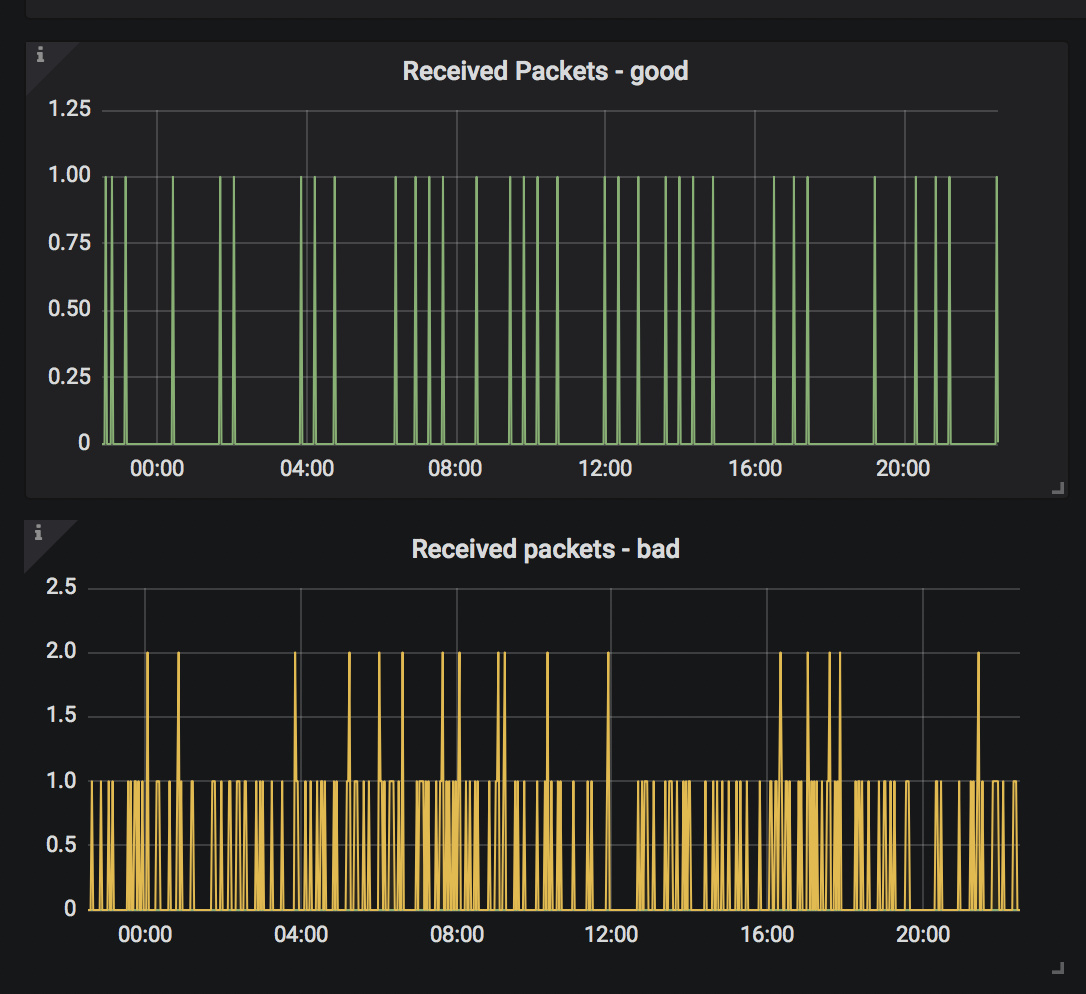

Thanks, I’ve seen that place. The problem is, that I receive a lot of packages with bad CRC, which are not forwarded. So I’m interested to lok at these locally. I know that I can enable forwarding, but why float the network with that traffic?

They may be at the edge of reception, or they may be LoRa (non -WAN) packets. I get a lot in west london:
(I say a lot
I mean the ratio of bad to good is high).
That’s what I guess too. Using a LoPy as single channel gateway, They show up as LORA coded packets with rssi levels of about -130 dBm, which is surely too low for a SF7BW125 coding. But still I’m interested to see that.
I know there are a lot of Lora - not just LoRaWAN - packets floating around to west of London from multiple IoT installations done by various companies over the last 4/5 years & makers/hobbyists, plus west of London distributors & sellers of LoRa chips (with demo systems etc.), modules, and LoRa products depending on location/elevation of GW its poss that Xmissions from further up the Thames Valley & elsewhere are being detected but not satisfactorily being decoded if on extreme fringe of viable reception.
